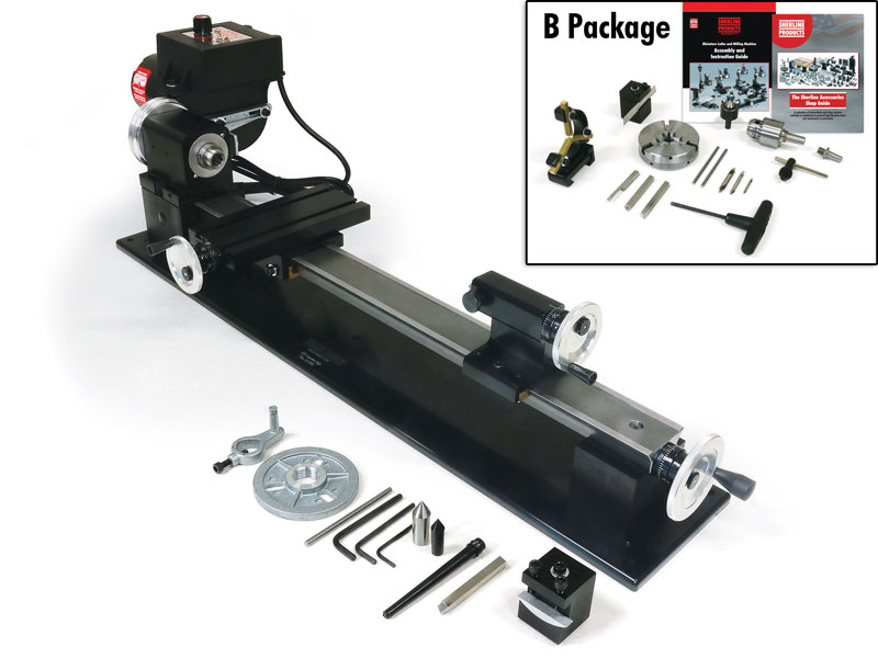

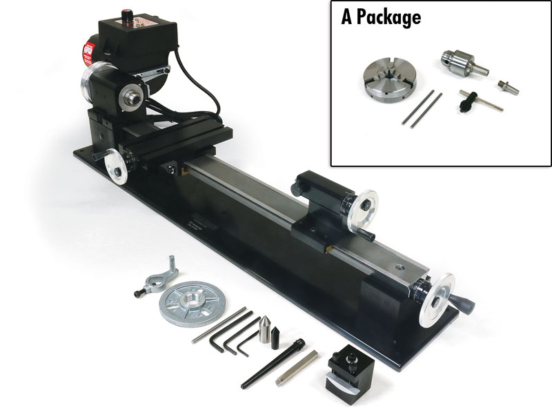

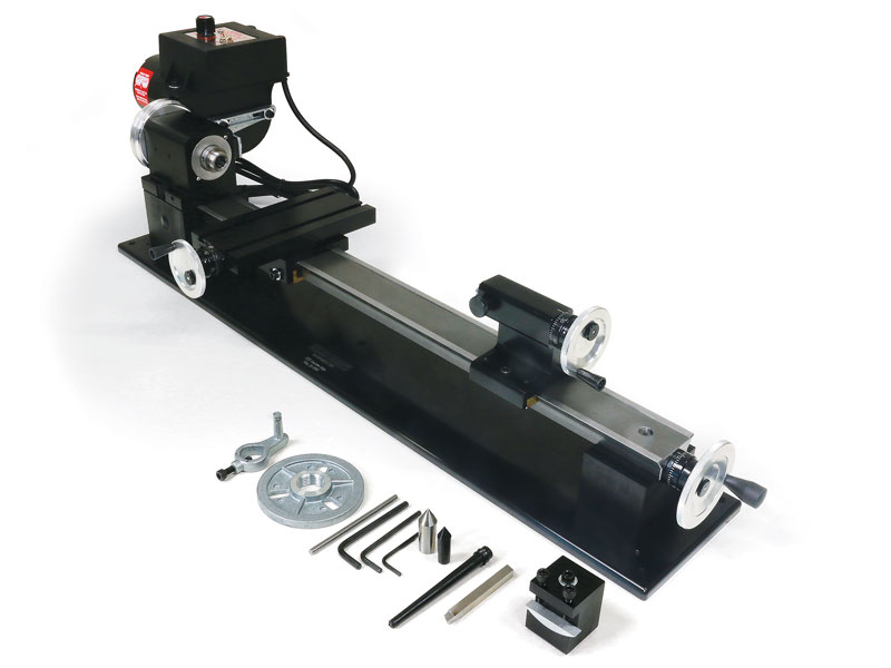

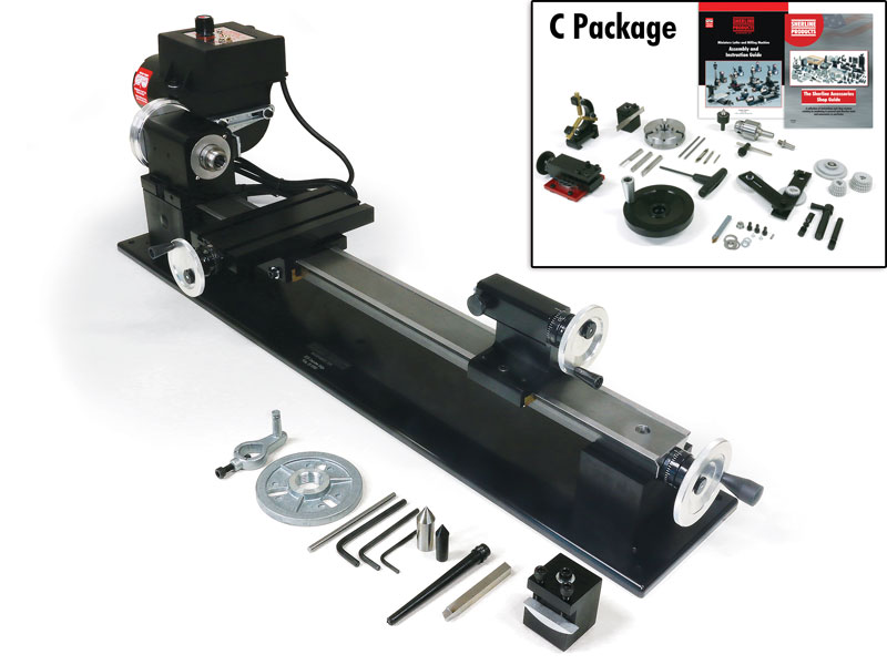

This 4000-series tabletop lathe can turn a part up to 3.5” in diameter over the bed or up to 1.88” over the carriage without riser blocks. With an optional riser block, parts up to 6” in diameter can be turned over the bed. The lathe has 8” of space between centers. The electronic speed control allows continuously variable speed control from 70 to 2,800 RPM without belt changes. There is a second pulley position available that offers extra torque at low RPM if needed. This lathe is a good choice for clockmakers, modelers, or those who will be working on small parts. It is also the most compact lathe we make and is easily used where space is at a premium and can be stored on a closet shelf.Our tabletop lathe is perfect for the customer looking for a mini lathe machine to make small, precision parts. All our mini lathes are made in the USA, and our customer service is second to none. Although our lathes are small, they can produce high-quality precision parts. Our 8" tabletop lathe will not only cut wood and plastic but is also rigid and accurate enough to cut aluminum and steel parts. This small lathe is a desktop-size machine with full-size machine precision and accuracy.Standard equipment includes:
  • 2.75" (70mm) x 6.0" (152mm) crosslide
  • 15" (381mm) steel bed to allow 8" (203mm) between centers
  • Standard 1-5/8" (41mm) laser-engraved aluminum handwheels
  • Pulleys, drive belt, faceplate, lathe dog, two dead centers, three hexagonal keys, tool post, sharpened high-speed steel cutting tool, eight-foot three-wire power cord, and instruction manual
