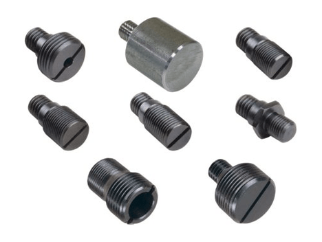

Chuck Adapters for Rotary Table
About the Rotary Table Chuck Adapters You can attach a 1/4″ or 3/8″ drill chuck, an older Unimat chuck with 12 x 1 mm or 14 x 1 mm threads, or a 1/2-20 Sears chuck to your Sherline rotary table. … Continued
