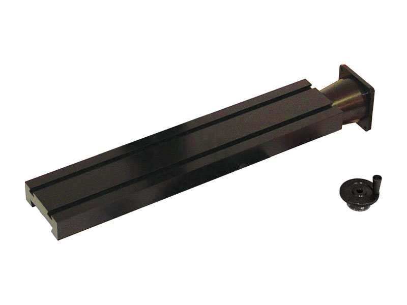

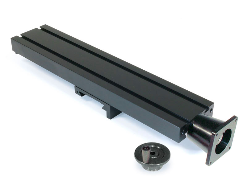

67036 8" CNC crosslide
8″ Lathe Crosslide – CNC
Does not include leadscrew.
$62.40 Add to cart
