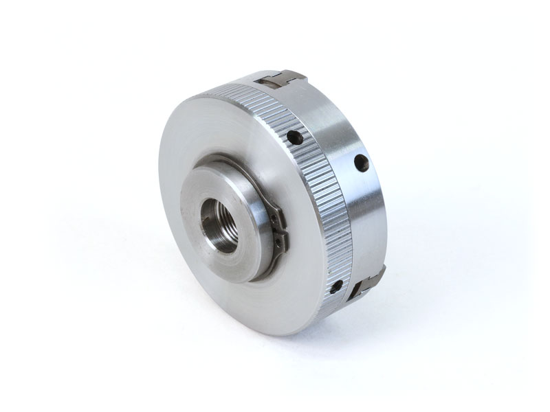

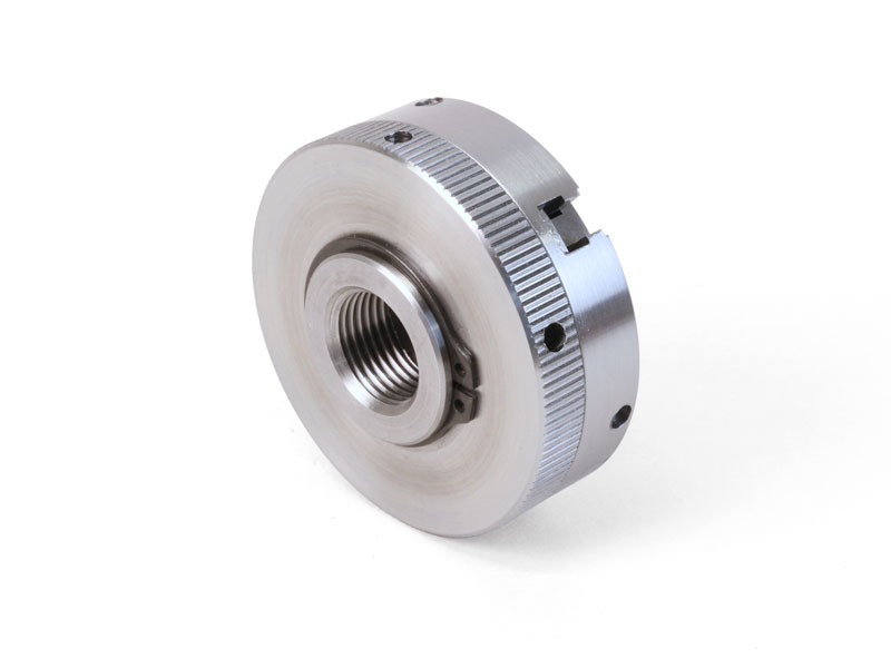

2.5″ 3-Jaw Chucks – Various Thread
Compatibility with Sherline and Other Lathes
Chucks are available with different spindle threads for use on Sherline lathes (3/4-16) and other machines such as older Unimat models (12mm x 1mm or 14mm x 1mm) or Sears 6″ lathes (1/2-20).
Note: Thread sizes other than 3/4″ x 16 are custom made and require 5–7 business days.

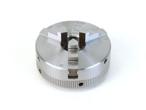

Jaw Options
  • Comments
Download PDF 1040 Instructions
Chuck Diameter2.5″
Jaw CapacityWith jaws in normal position: 3/32″ (2mm) – 1-3/16″ (30mm)
With jaws in reverse position: 1/4″ (6mm) – 2-1/4″ (56mm)
Through Hole Diameter.687″ (17mm)
Thread SizeP/N 1041 – 3/4-16 (Sherline)
P/N 1068 – 12mm x 1mm (Unimat SL 1000)
P/N 1070 – 1/2-20 (Old Sears 6″ Lathes)
P/N 1031 – 14mm x 1mm (Unimat 3 or Cowells)
Chuck Body Material12L14 Steel
Chuck Jaws Material12L14 Case Hardened Steel
I.D. Holding diameter of jaws
NOTE: The diameters shown on the print can vary as much as .010-.020 depending on the amount of material that is removed during the grinding operation.
