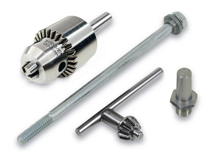

3/8″ Drill Chuck with Two Arbors
SKU: 1069 Category:
This chuck includes a #0 Morse arbor for use in the tailstock for center drilling and a #1 Morse arbor for use in the headstock. It will hold drills from 3/32″ (2.4 mm) to 3/8″ (9.5 mm) in diameter.  Runout is .003″ or less. If runout of less than this amount is required, collets should be used to hold the drill rather than a chuck.
NOTE: Because of its longer length and ability to hold longer 3/8″ drills, this chuck is normally recommended for use on the longer 4400-series benchtop lathes.
Download PDF 1072 Instructions
Chuck Capacity1/32″ – 3/8″ (0.8-10 mm)
Arbor#0 Morse for tailstock and #1 Morse for headstock
Runout.003″ or less
Includeschuck key, drawbolt+washer and 2 arbors
Part No.DescriptionQuantity
11861Rohm S8 chuck key1
11880Threaded arbor – #1 Morse taper1
11890Threaded arbor – #0 Morse taper1
118013/8″ drill chuck body1
308801/4-20 x 5″ drawbolt with centering washer1
