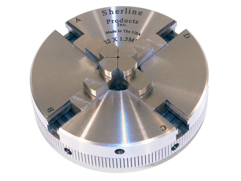

Sherline offers their 3.1″ 4-jaw self-centering chucks with a 22 x 1.5 mm threaded hole for use on Sherline’s optional ER-16 spindle nose. They can also be used with certain other ER-16 spindles that use the 22 x 1.5mm thread for the collet nut.
Self-centering chucks offer a quick and convenient way to hold a work piece while it is turned on the lathe. A chuck can also be clamped to a mill table to hold a part for milling. Sherline manufactures our own chucks to a high degree of precision on CNC machines. The jaws are ground and fitted to each chuck by skilled technicians to assure maximum accuracy. Runout is specified to be .003″ or less at the chuck jaws.

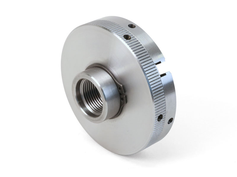

NOTE: The chuck should not be used in applications where spindle speed exceeds 3000 RPM. If purchasing any of these chucks for use on a non-Sherline ER-16 spindle, confirm that the spindle nose thread is 22 x 1.5 mm before purchasing. The Sherline chuck has a collar that is machined flat at the back to seat against the face of the Sherline ER-16 spindle. This may not be compatible with some non-Sherline ER-16 collet adapters or industrial tool holders. Runout accuracy cannot be guaranteed unless used with a Sherline spindle.

Chuck Diameter3.1″
Jaw CapacityWith jaws in normal position: 3/32″ (2mm) – 1-1/2″ (38mm)
With jaws in reverse position: 1/4″ (6mm) – 2-3/4″ (70mm)
Through Hole Diameter.687″ (17mm)
Thread Size22mm x 1.5mm
Chuck Body Material12L14 Steel
Chuck Jaws Material12L14 Case Hardened Steel
Part No.DescriptionQuantity
107803.1″ 4 Jaw Chuck Body ER16 – M22 X 1.5 Thread1
104023.1″ Chuck Scroll1
10413Chuck Retainer Ring1
117714 Jaw Chuck Jaw – Self Centering*4
40580Tommy Bar2
