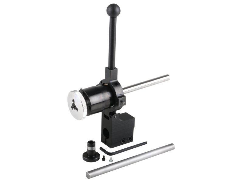

Anyone doing repetitive lathe operations on small parts will find this new accessory saves a lot of time when holding parts into a WW collet. Instead of loosening and re-tightening the drawbar each time a part is inserted, you make that adjustment just one time with this closer. After that, the collet is released and re-tightened simply by pushing a lever back and forth. Moving the lever to the right releases the part from the collet, a new part is inserted, and the lever is moved back to the left to lock the part in the collet. Hardened steel components assure long life.

- Easy to install—just tap one existing 4-40 hole in the spindle if not already tapped for threading attachment (self-tapping screw included)
- Wear parts are made from A2 hardened steel, the yoke is made from 1018 steel and ball carrier, and other parts are made from brass and 12L14 steel
- Long stock up to 3/16″ in diameter can be passed all the way through the spindle and collet
- Larger parts can be held with WW collets up to 8 mm (3/8″) or in a custom-machined WW pot chuck

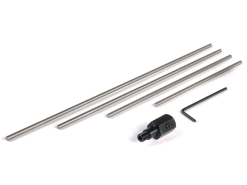

- Includes a 3/8″ knockout bar plus a special #1 Morse to WW collet adapter with a pin to engage the keyway in the collet to prevent rotation
- As usual, installation and operation are covered in the thorough, illustrated instructions that come with it
