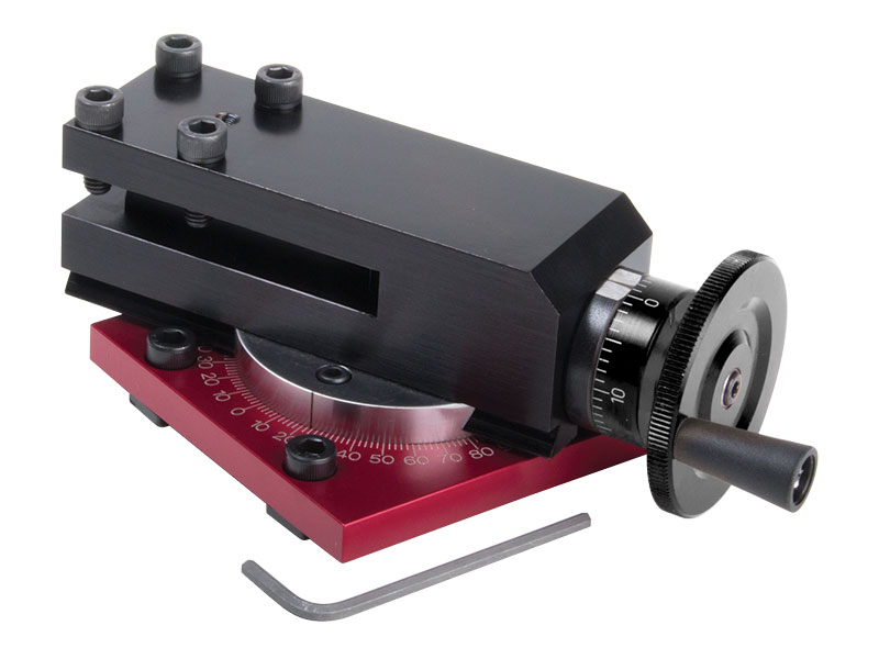

The compound slide offers a way to turn tapers and cut angles on a lathe without rotating the headstock. Four mounting holes are in the base for solid positioning on the crosslide. The base has a red anodized finish with laser engraved angle scales to make setting an angle easy. It utilizes a highly efficient locking ring design to lock it in position without having to overtighten the locking screws. A 1/4″ cutting tool can be mounted across the front or on either side of the head.
NOTE: Our 3/8″ shank, insert tool holders will not work with the compound slide.
Unlike compounds used on full-size, conventional lathes, this one was designed to be used from the “back” side of the table. This setup allows it to be designed in a more compact size and used without interference from the crosslide handwheel. The lathe tool is inserted in the holder “upside-down,” so the cutting tip faces downward. Because of the miniature lathe’s small size, operating the crosslide handwheel in this position is just as convenient.
A Compound Riser Block is available for use with this item (see below).
Travel of the slide block is up to 1.75″ when square to the base or angled slightly. When angled 45°, the handwheel will hit the corner of the base, shortening travel to about 1.25″. At angles between about 20° and 45°, travel is restricted between the two dimensions depending on the angle.
The Sherline compound slide is available in both inch and metric versions. On the inch version, the handwheel is calibrated in .001″ increments driving a 20 TPI leadscrew. On the metric version, the handwheel is calibrated in .01 mm increments driving a 1 mm pitch leadscrew. The inch handwheels have 50 marks (one revolution = 0.050″). The metric handwheels have 100 marks (one revolution = 1.0 mm).
1270_demoThe compound slide offers another way to cut tapers. The slide is used on the “back” side of the table with the tool upside down.
