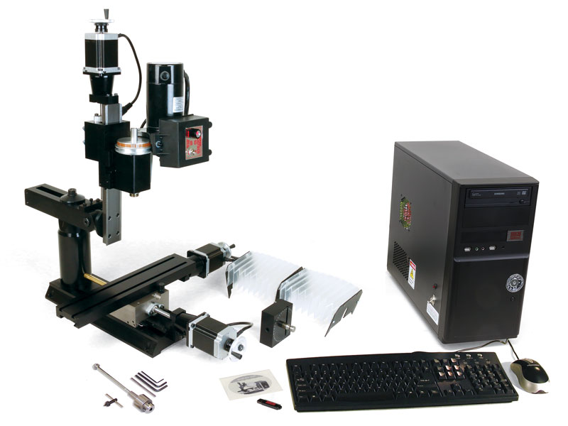

The 86820 CNC Package Includes:
  • 14″ mill fitted ball screws and all new saddles developed for the ball screws.
  • 3 High-Torque Stepper motors with couplings and mounts.
  • A computer with 4-Axis Drive Box and Ubuntu Linux-based OS with LinuxCNC software preinstalled
  • Keyboard and mouse
You supply only a monitor.
