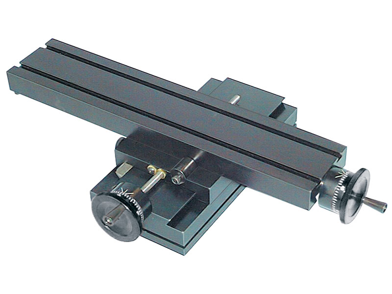

The Sherline industrial 2-axis slide was developed from components of the X/Y base of the Sherline miniature milling machine. The movements are designated as the X-axis and the Y-axis like a milling machine. The Y-axis moves the table in and out. The X-axis moves the table from side to side. If the table is mounted vertically, the side-to-side travel is still called the X-axis, but the vertical travel would then be called the Z-axis.
  1. The slides are manufactured from 6061-T6 aluminum and finished with a black anodized coating.
  2. The 2-axis manual machine slides are available with table lengths of 13″ or 18″, and any table is available with either an inch or metric leadscrew.
  3. Leadscrews are precision rolled from steel, and table screws are located under the table, out of the way of chips. Leadscrew backlash is adjustable.
  4. Dovetailed tables and saddles have adjustable gibs to eliminate play.
  5. Handwheels are graduated in .001″ increments on inch slides and in .01 mm increments on metric slides.
Mounting Provisions
FROM THE BOTTOM—Four 1/4-20 holes are provided in the base’s bottom on 2-inch centers for mounting.
FROM THE TOP—If access is not available from the bottom, the slide can be mounted from the top using the four angle clamps provided. They slide into the groove around the perimeter of the base, and holes are drilled in the mounting surface and tapped to accept the 10-32 socket head cap screws provided. Use all four clamps for the most secure mount.

Download PDF 6540 Instructions
6540 (6541) 13″ table6540-18 (6541-18) 18″ table
Table size13″ x 2.75″ (330 mm x 70 mm)18″ x 2.75″ (458 mm x 70 mm)
Table height2.8″ (71.1 mm)2.8″ (71.1 mm)
X-axis travel9.0″ (228 mm)13.38″ (340 mm)
Y-axis travel4.1″ (104 mm)4.1″ (104 mm)
Hold-down provision2 T-slots*2 T-slots*
Mounting provision4 holes 1/4-20 in the bottom of the base plus slot for angle clamps4 holes 1/4-20 in the bottom of the base plus slot for angle clamps
Handwheel2″ laser engraved aluminum with two pre-loaded ball bearings2″ laser engraved aluminum with two pre-loaded ball bearings
* NOTE: Sherline 10-32 T-nuts that fit the table T-slots are available in a package of 10 as P/N 3056.
