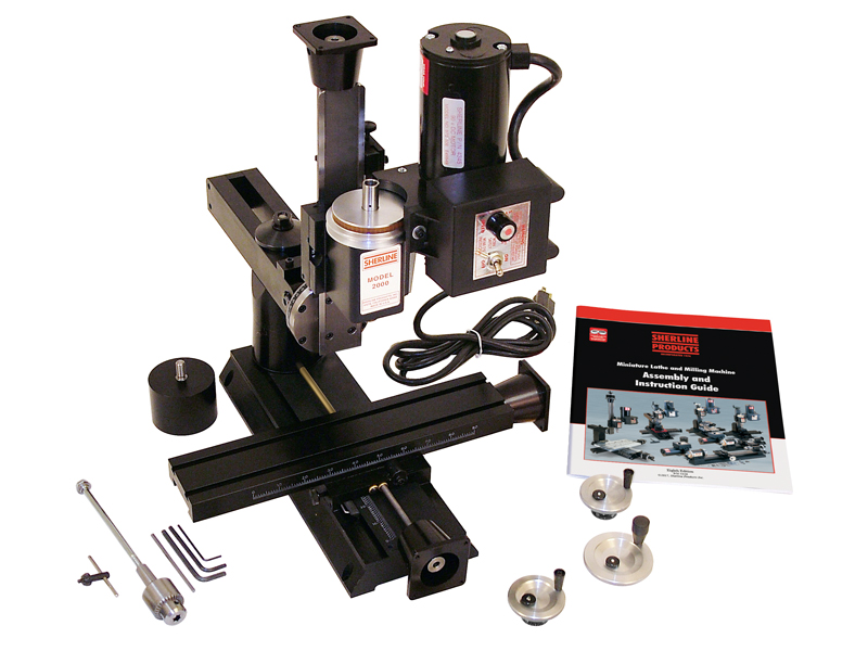

The 8-Direction CNC-Ready Milling Machine is one of the most versatile mills Sherline offers. In addition to standard X-, Y-, and Z-axis movement, this model provides five additional directions of headstock adjustment—allowing you to position the spindle for drilling or milling operations from nearly any angle.
- The headstock pivots up to 90° left or right.
- The column bed also rotates side to side up to 90°, enabling angled drilling.
- A specialized knuckle joint allows the column to tilt front to back.
- The ram-style column base can swing side to side up to 90°, offering even greater flexibility.
- Loosening the column cap lets the ram move in and out, providing over 5.5″ of additional travel.
With this wide range of movement, the machining possibilities are nearly limitless within the compact work envelope of the machine. The 14″ base also increases Y-axis travel by 2″ compared to the Model 5400 mill, making it a powerful tool for advanced miniature machining applications.
The 8-Direction benchtop mill is ideal for users who need a small, precision milling machine capable of high-accuracy work. Like all Sherline mills, it is made in the USA and supported by unmatched customer service. Despite its compact size, this 14″ benchtop mill is engineered to handle wood, plastic, aluminum, and even steel—delivering full-size machine precision in a desktop footprint.
Note on Ordering a Metric Mill – Most Sherline cutting tool, such as center drills, are offered in fractional sizes. If you opt for a metric machine with metric collets or holders, you’ll need to order compatible fractional-size holders to use these tools effectively.

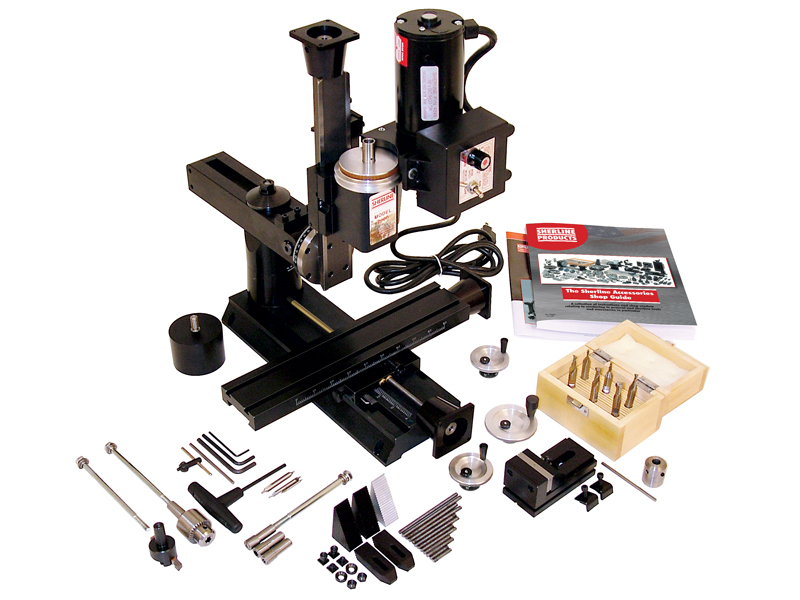

Standard Equipment for the 14″ 8-Direction Tabletop Mill
- 14″ base with laser-engraved scales
- 2.75″ (70 mm) x 13.0″ (330 mm) table with laser-engraved scales and two T-slots
- 2″ column riser block
- Resettable, zero-adjustable handwheels that can be mounted to the end of the stepper motors to maintain manual control when needed:
- (2) 2″ (51 mm) handwheels on X- and Y-axes
- (1) 2-1/2″ (63 mm) handwheel on Z-axis
- NOTE: CNC-ready machines cannot be operated manually unless double-shaft stepper motors are installed.
