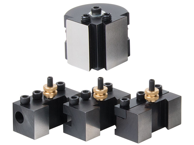

About the Quick-Change Tool Post and Holders
This accessory brings to your Sherline lathe the ability to change tools quickly and easily. It uses a dovetail design to locate removable holders in a fashion similar to that used in production machine shops. The case hardened steel tool post has two machined dovetails to accept the three included tool holders. The three interchangeable tool holders are designed to hold a 3/8″ round boring bar, a 1/4″ HSS cutting tool, and a cut-off blade (cutting tools are not included). Each holder has two knurled brass knobs; the lower knob allows you to easily adjust the height of the tooltip, while the upper brass knob locks the height in place. Changing tool holders is simply a matter of releasing the locking screw on the tool post, sliding out one tool holder, sliding in another, and re-locking. If you find your jobs require a lot of tool changes, this timesaving accessory will make your projects that much more of a pleasure.

Pictured below are two optional holders. P/N 2282 holds 3/8″ square shank tools. P/N 2295 comes with a 55° carbide insert. The post and holders are all machined from steel and have a black oxide finish. Knurled brass knobs adjust tool height.
