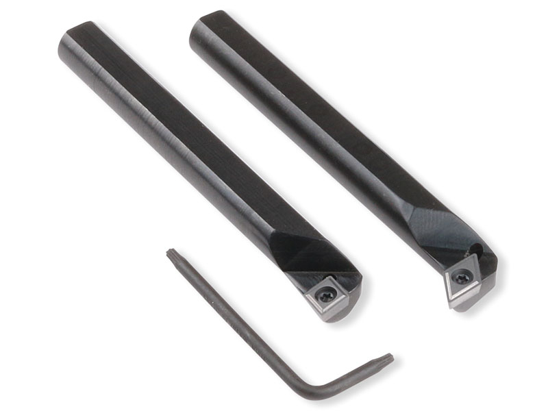

LH 55° & 80° 3/8″ Boring Bars w/Carbide Inserts
These 3/8″ diameter boring bars hold a carbide insert secured with a Torx screw.  Each comes with either a 2-sided  55° or 80° carbide insert and Torx wrench. The 55° LH boring tool will fit into a 3/4″ starting hole. The 80° holder will fit into a smaller 1/2″ hole. The 80° holder offers a little more strength for roughing cuts while the 55° insert will cut into sharper corners. The 3-1/4″ long holder can bore a hole a little over 2″ deep with two fastening screws tightened on it. The holders are made from 1144 Stress-proof steel with a black oxide finish. Available individually.
Left Hand Boring Bars
These LH boring bars are not intended to be used for boring on a standard Sherline lathe, as the spindle is not reversible without electronic modifications. They were developed for a Sherline tool that is now in development where they will be used as a turning tool from the backside with the bit upside down. Watch for the introduction of this new “chucker” lathe soon.
