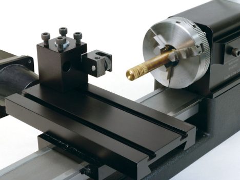

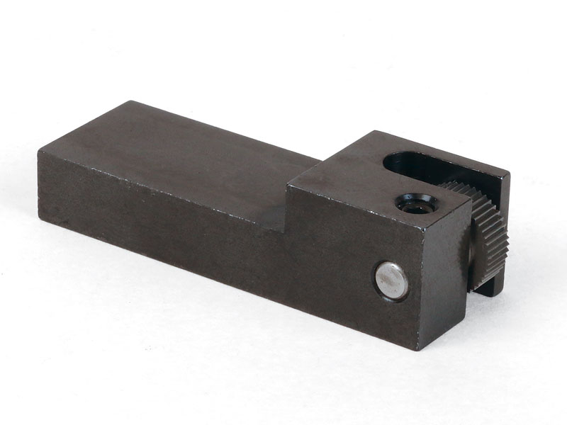

Our bump knurl holder was designed primarily so customers who have CNC machines could add a knurling operation to their program, but it can also be used on a manual lathe. This holder is the same style that is used on full-sized CNC machines. The part is held in position using the 3/8″ Insert Holder Tool Post (P/N 7600, not included).
P/N 2275 Bump Knurl Tool Holder shown engaged with a part.

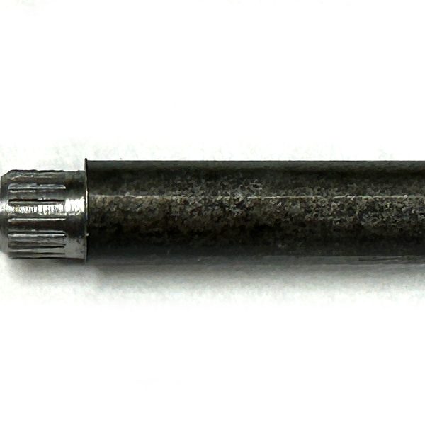

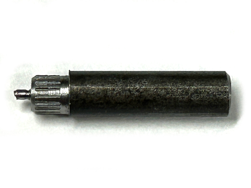

- The part in the images below (Examples 1 & 2) is our handwheel knob shaft (P/N 42050). This part is 3/16″ diameter, and the material is 12L14 steel. The bump knurling operation on this part is done as close to the collet as possible.
- After your first part is knurled, you may find that your knurl is tapered. This is due to the part flex. You can compensate for this taper to some extent by turning the bump knurl holder at a slight reverse taper angle. This will cause one side of the knurl to make contact with the high side of the tapered knurl first, resulting in a less tapered knurl.
