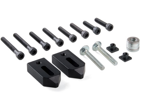

About the Standard Mill Hold-Down Set
Sherline now offers two types of hold-down sets; standard and step block. The standard set offers a simple and versatile method of clamping work to the mill table.
This basic hold-down set consists of two strap clamps complete with bolts, T-nuts, washers, and a variety of lengths of socket head cap screws. These clamps are adjustable so that they can accommodate materials of different thickness, and they can be used to hold parts of almost any shape. Height is adjusted by turning the carriage bolt. The round head of the carriage bolt is placed on a washer on the mill table to keep from damaging the table surface. The various length socket head screws are used in T-nuts in the table slots to pull the clamp down on the part. Maximum height adjustment is about 1-3/16″ with the screws provided.
Download PDF 3012 Instructions
30130(2) Hold Down Clamp
30140(2) 10-24 X 1-1/4″ Carriage Bolt
30561(2) 10-32 T-nuts
40340(2) 10-32 X 1″ SHC Screw
40660(10) #10 Washer 3/16
40710(2) 10-32 X 1-1/4″ SHC Screw
40720(2) 10-32 X 1-1/2″ SHC Screw
40740(2) 10-32 X 7/8″ SHC Screw
