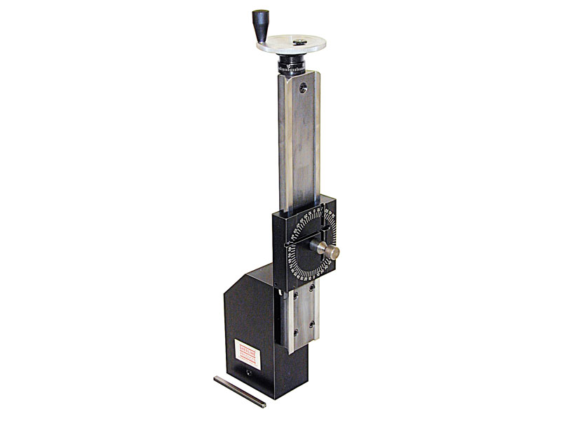

With this attachment, the Sherline lathe can be quickly and easily converted into a small milling machine. The attachment consists of a steel dovetailed vertical column with a solid aluminum base that attaches to the bed of the lathe in place of the headstock. The headstock then mounts to a dovetailed saddle on the vertical column. The saddle is raised and lowered to control the depth of cut by turning a handwheel. On the deluxe version, a 2-1/2″ adjustable “zero” handwheel replaces the standard handwheel. Parts to be machined are mounted on the crosslide.

Deluxe vertical milling column mounted to Model 4000 lathe.
Explanation of terms: As used in reference to the Sherline product line, a MILL COLUMN is a column used on a mill. It is held in place on the mill base with two 1/4-20 bolts. A VERTICAL MILLING COLUMN is used on the lathe to add a milling capability. It has a large hole in the center that fits over the headstock pin on the lathe base and is held in place with a set screw. The lathe’s headstock/motor/speed control unit is relocated from the pin on the base to the pin on the vertical milling column saddle. In practice, all vertical milling column bases now have both the single hole for the pin AND the two holes for use on a mill base, so they can be used for either application, whereas mill columns can only be used on a mill base.
