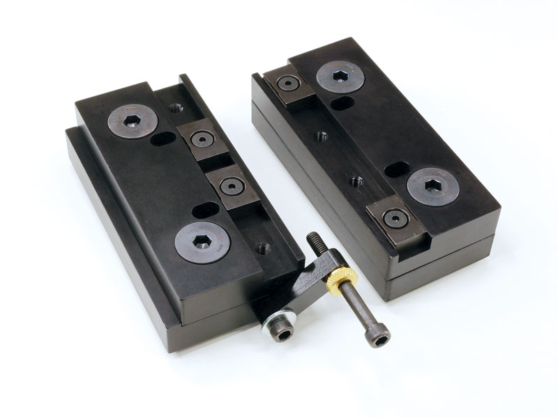

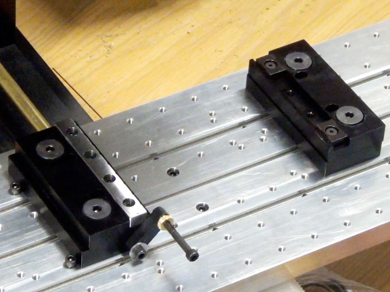

The Sherline MB Vise Fixture is designed to locate directly in the T-slots of our mill tables and tooling plates. By aligning the fixed and movable jaws in the T-slots, your mill table or tooling plate becomes the base for the fixture—maximizing usable table length. This setup allows you to securely hold and machine much larger or irregularly shaped parts than traditional vises can accommodate.
Workholding Versatility
The MB Vise Fixture supports a wide range of part shapes through the use of two different sets of interchangeable top jaws:

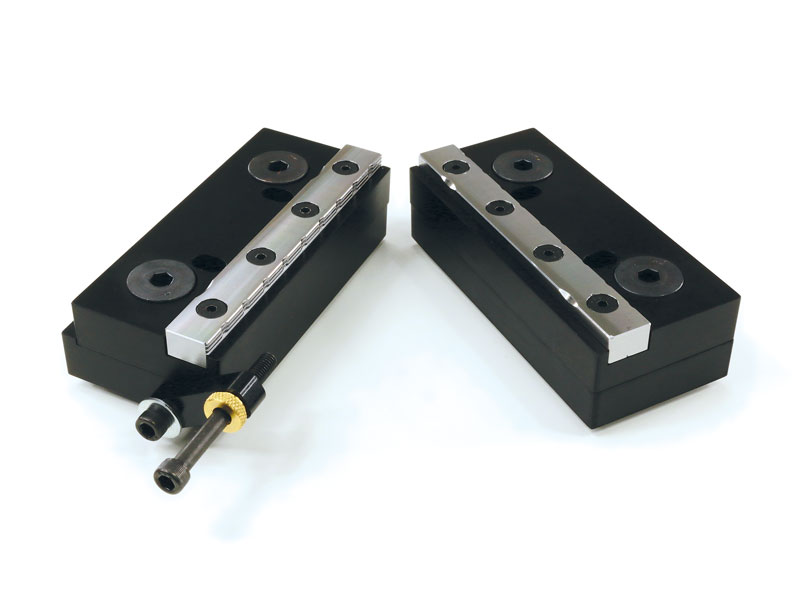

For square and rectangular stock use the standard top jaws with either:
For round or irregularly shaped material:

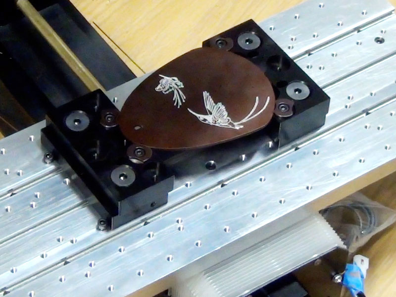

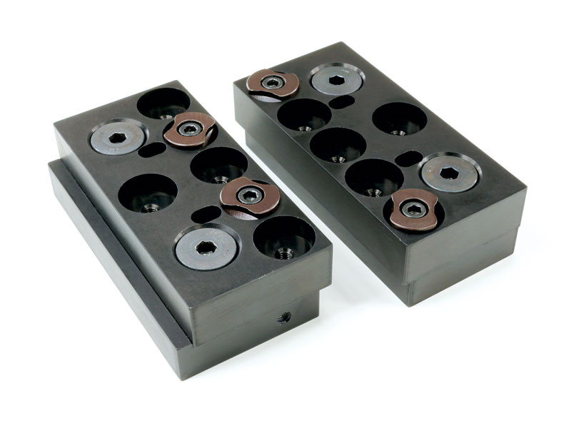

Use the MB Versagrip Top Jaws (P/N 35535), which fit the same fixed and movable base plates. These jaws accept the MB Versagrip Vise Jaw Inserts (P/N 35529) by Mitee-Bite. The ¾” round inserts can be rotated within any insert pocket to match and grip a wide variety of part geometries securely.

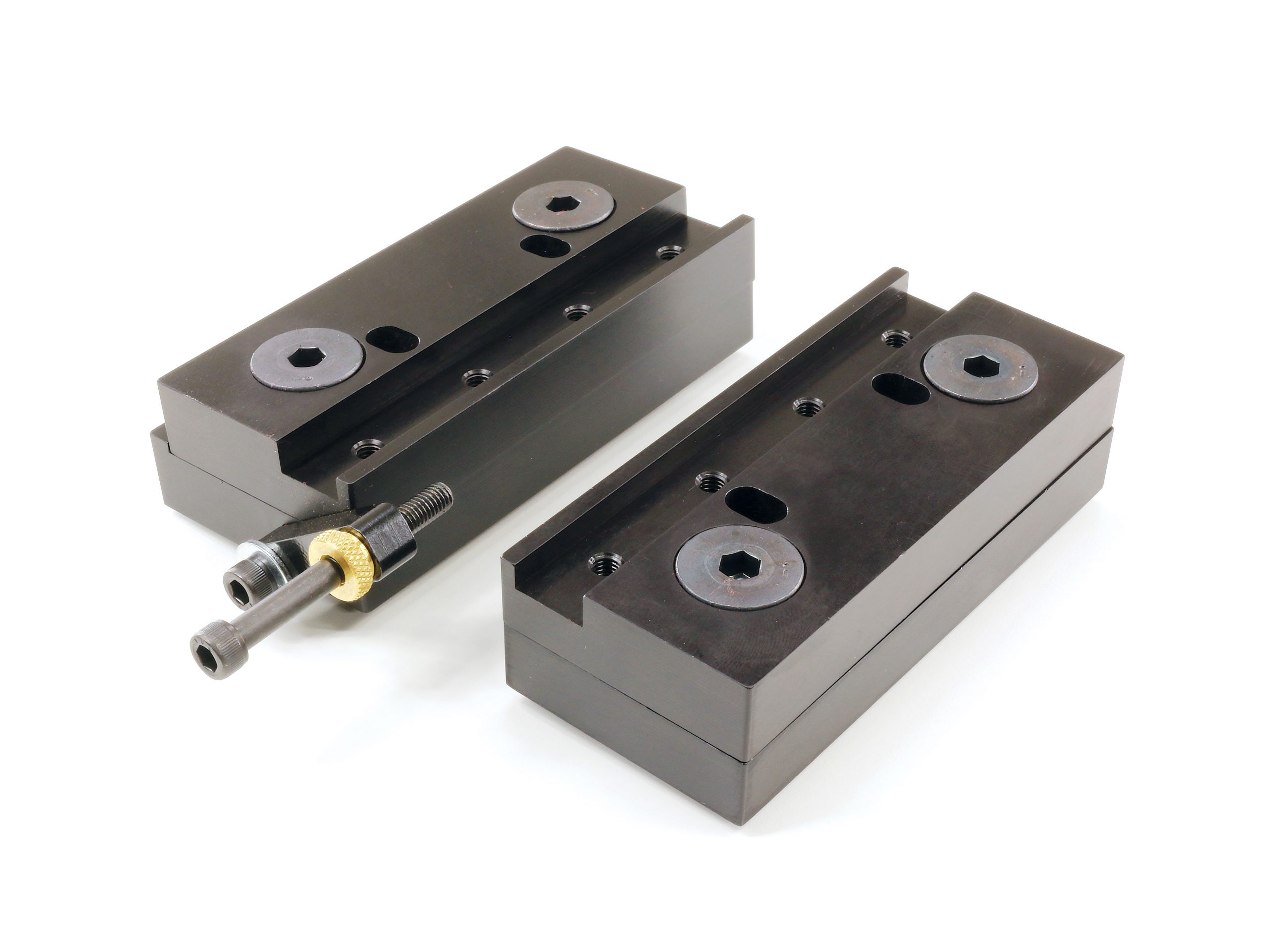

Standard MB Vise Fixture Includes:
  • Fixed base plate
  • Movable base plate

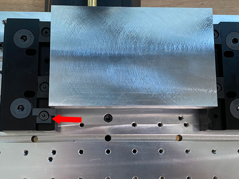

  • Adjustable stop
  • 3 hex keys (7/32″, 5/32″, 3/32″)
  • Mounting screws and T-nuts

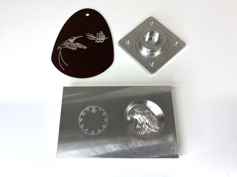

Sherline MB Vise Demo-Engraving a Hummingbird
