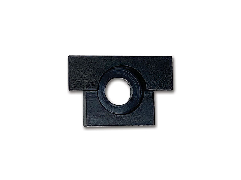

Hard stop for the MB Vise Fixture with Talon Grips (P/N 3552-35526).
What’s included in each set:
- One vise fixture hard stop
- One socket head cap screw (not shown)

P/N 35528 – MB Hard Stop:
Designed to fit in the fixed jaw insert slot and used alongside the Talon Grip Inserts (P/N 35526) for repeatable part positioning.
