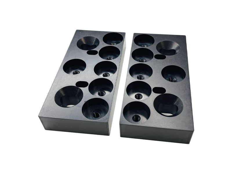

MB Vise Versagrip Top Jaws
The MB Versagrip Top Jaws are used for holding round or oddly shaped stock. These top jaws use the MB Versagrip Vise Jaw Inserts (P/N 35529) made by Mitee-Bite*. You can place the jaw inserts into any insert pockets in the MB Versagrip top jaws to accommodate differently shaped parts.
*NOTE: The MB Versagrip Vise Jaw Inserts are sold separately.

For round or irregularly shaped material:
Use the MB Versagrip Top Jaws (P/N 35535), which fit the same fixed and movable base plates. These jaws accept the MB Versagrip Vise Jaw Inserts (P/N 35529) by Mitee-Bite. The ¾" round inserts can be rotated within any insert pocket to match and grip a wide variety of part geometries securely.

Double-sided serrated inserts for aggressive holding of raw stock. The serrated edge enhances grip strength (includes 2 inserts and 2 screws).P/Ns 35535 & 35529 – MB Versagrip Vise Jaws & Inserts:
Serrated on both sides for secure gripping of raw or irregular material. Compatible only with the Versagrip jaws (includes 4 inserts and 4 screws).P/N 35528 – MB Hard Stop:

MB Vise Versagrip Jaw Inserts
These inserts have two serrated sides and bite into the part surface for holding raw material. They are only compatible with the Versagrip top jaws (P/N 35535).
What's included in each set:- Four Versagrip jaw inserts
- Four socket head cap screws (not shown)
