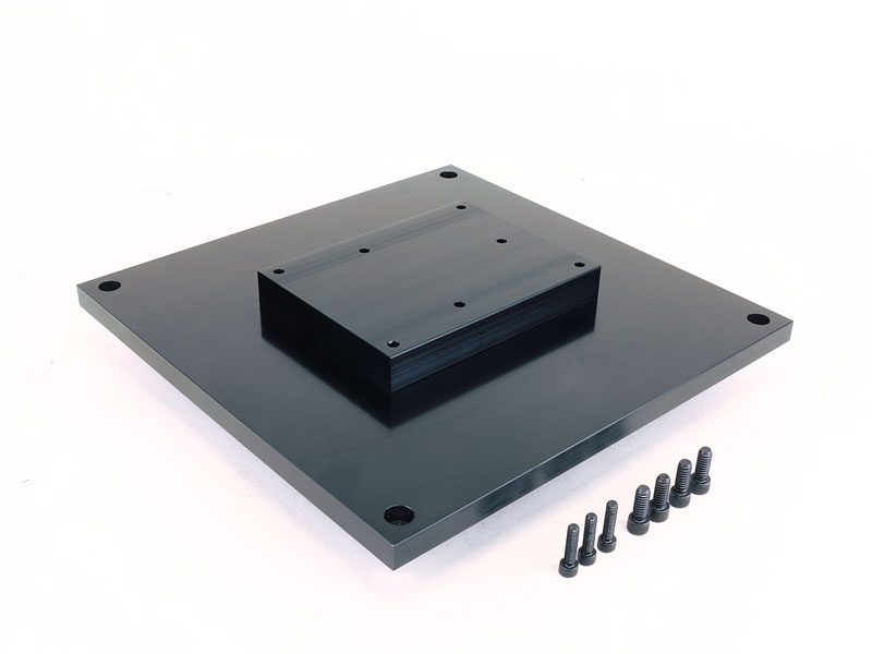

About the Rotary Scanner Riser Block and Base
This base plate is designed to stabilize the Sherline 4” rotary table when it is used with a scanning plate to hold large or heavy objects for laser scanning. The large 10” x 10” base is a 1/2″ thick and offers substantial support to keep the table from tipping if the scanned object is not perfectly centered. The 5 1/4″ x 4″ riser block raises the rotary table an additional 3/4″ above the base plate to provide clearance for the stepper motor. The total height of both plates is 1 1/4″. Holes are provided for mounting the rotary table to the base plate and also for mounting the base plate to a stable platform for additional security. The plates have a tough black anodized finish. Fastening screws are provided.
3728_w_rotary_pic
Rotary table not included, shown for reference only.
Kit includes seven socket-head screws to assemble the plates (rotary table purchased separately).

Base Dimensions H x W x D1/2″ x 10″ x 10″
Riser Block Dimensions H x W x D3/4″ x 5-1/4″ x 4″
MaterialAluminum
Body CoatingBlack Anodized
37260Rotary Table Scanning Plate Base
37270Rotary Table Scanning Plate Riser Block
40690(3) 10-32 x 3/4″
61110(4) 1/4-20 x 5/8″
