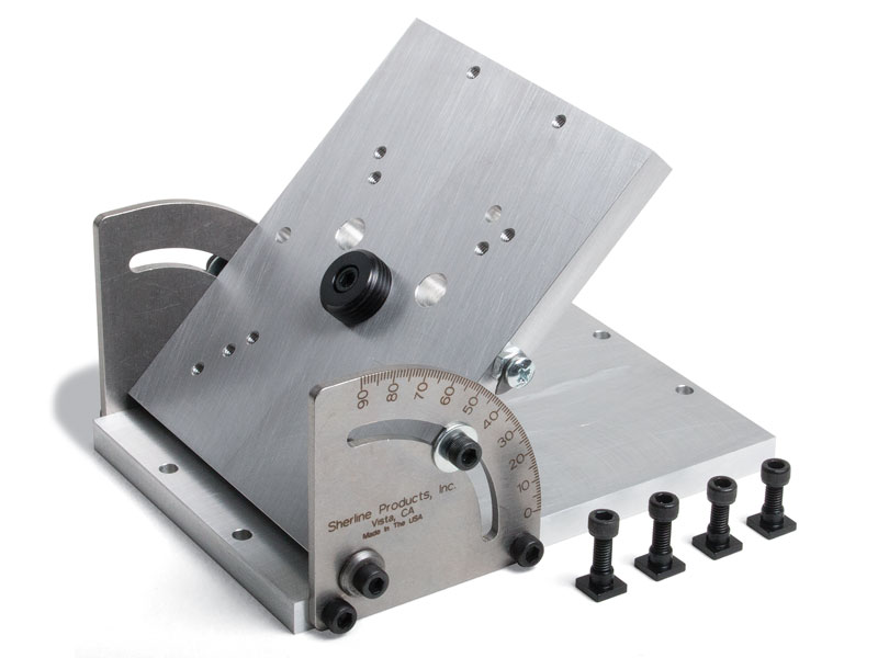

About the Tilting Angle Table
This accessory offers a great variety of setup options. With the base mounted square to the mill table, parts mounted to the tilted table can be machined or drilled at precise angles. It can be set at any angle from 0° to 90°. The hole pattern in the table accepts Sherline’s mill vise and rotary table. A threaded chuck mount is also included, which means parts from the lathe can have machining operations done on them without removing them from the chuck. They can then be put back on the lathe for further operations without re-centering.

Chamfers can be milled using the tilting angle table on a mill.
With the rotary table mounted to the table and tilted, many additional machining possibilities are opened up. The pre-drilled and tapped hole pattern is laid out so that when the rotary table is rotated to the 90° position, its center is the same height as the right angle adjustable tailstock P/N 3702. This eliminates the need for the P/N 3701 right-angle attachment.
Like the 90° Angle Plate P/N 3559 and the Rotary Table P/N 3700, this accessory can also be useful for setups on other machines besides your Sherline machines.
