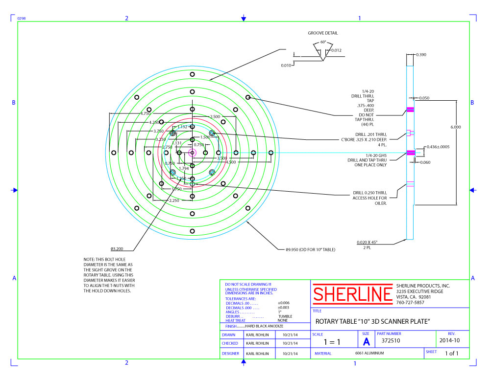

These tooling plates are designed to be mounted to the Sherline 4″ CNC Rotary table to hold parts that are being laser scanned. Each plate has a pattern of 10-32 threaded holes for use in holding fixtures to align parts for 3D laser scanning. A series of concentric circles are also machined into the face of the plate to aid in visual centering of the parts to be scanned. An access hole is provided that should be aligned with the oiler hole on the surface of the rotary table for lubrication. On the bottom of the table, an alignment protrusion is provided that helps center the plate on the counter-bored hole in the center of the rotary table. Four 10-32 socket head cap screws and T-nuts are provided with each plate for securing it to the T-slots on the rotary table’s surface. The aluminum plates have a tough black anodized finish.

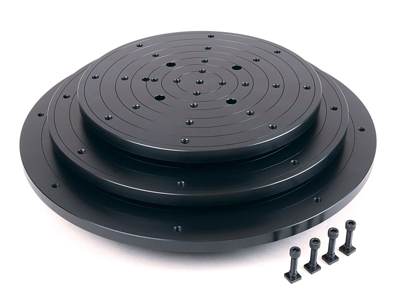

3726-27-28laz_picAll three plates are shown here in one photo as a means of comparison. They come in sizes 8″, 10″, and 12″ in diameter. All are designed to be used on Sherline 4″ Rotary Tables.

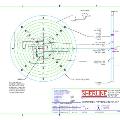

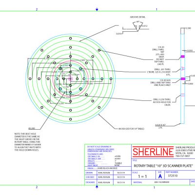

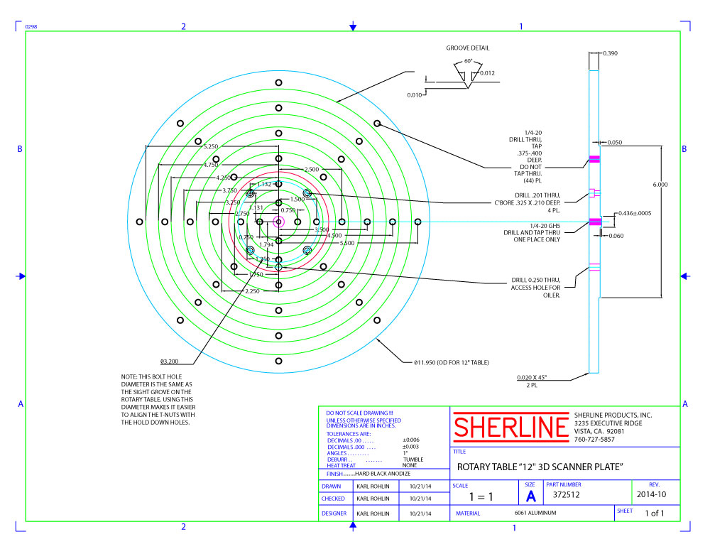

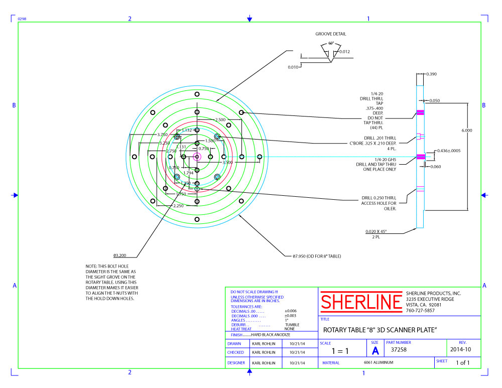

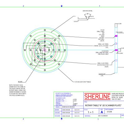

Hole dimensions and locations on our scanner plates
Click on the images below for a larger view.
