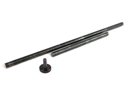

Starting in August, 2015 every Sherline headstock now includes the holes to add an optional hard stop. The hard stop kit, P/N 40116 includes two steel rods and a knurled thumbscrew lock. The .242″ diameter steel rods are 4″ and 8″ long. A hole through the headstock base allows the hard stop rod to be set to contact the lathe crosslide, providing a hard stop for the Z axis during turning operations.
This hard stop can also be used in many instances on the mill headstock, as a hard stop for drilling depths.
For those who have an older Sherline lathe and want to add the hard stop, the kit includes instructions with dimensions on where your headstock case will need to be drilled to accept the rod and locking thumbscrew. Complete instructions are included.

What is included
  • 4″ hard stop rod
  • 8″ hard stop rod
  • 10-32 x 5/8″ thumb screw
