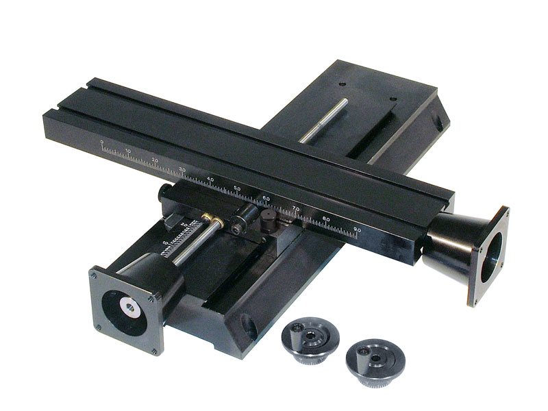

About the 14″ 8-Direction CNC-Ready Benchtop Mill XY Base
The 8-Direction Benchtop Mill XY base is the same base used in our 2000-series CNC-ready benchtop mill.
It has stepper motor mounts on each axis, ready for the installation of stepper motors. (Stepper motors not included, see the STEPPER MOTOR page.) Handwheels are included and can be mounted to the end of the stepper motors to maintain manual control when needed.* The table and base have laser-engraved scales.
Standard Features for the 8-Direction CNC-Ready Benchtop Mill XY Base
  • 14″ Mill Base
  • 13″ Mill Table
  • NEMA #23 Stepper motor mounts on the X- and Y-axes
  • 2″ (51mm) resettable, zero adjustable handwheels on the X- and Y-axes. Each handwheel has laser-engraved aluminum handwheel collars.
  • Oil reservoir on the X/Y axes
  • Travel: X=8.65″ (220 mm), Y=7.0″ (178 mm)
