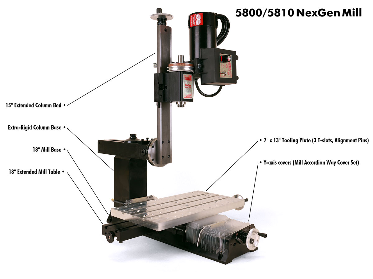

The Sherline NexGen Benchtop Mill is the largest vertical milling machine we offer. As Sherline mills have become increasingly popular in industrial, laboratory, and educational settings, the need for a larger-capacity mill led to the development of the NexGen model. This benchtop mill features an expanded mill base, a longer crosslide table, and an extended column—providing greater work area and capability than our Deluxe 8-Direction Benchtop Mill (Series 2000/2100).
To fully support the extended travel of the column, we’ve increased the cross-section of the column base for added rigidity. To further improve stability during heavy cuts, the column arm no longer swings side to side. However, you still retain full flexibility with 90° rotation to the left and right, as well as in-and-out column movement—giving the NexGen mill a total of seven directions of adjustment, including X, Y, Z, and headstock rotation.
The NexGen mill is ideal for customers seeking a compact, high-precision mini mill for small parts. All Sherline milling machines are made in the USA and backed by exceptional customer support. Despite its small footprint, this 18″ benchtop mill delivers full-size machining accuracy. It’s capable of cutting wood, plastic, aluminum, and even steel with precision and rigidity.

  • Powerful 90V DC motor with electronic speed control
  • 2.75″ (70 mm) × 18.0″ (457 mm) extended mill table with two T-slots
  • 7″ × 13″ tooling plate
  • 15″ (63 mm) extended column bed
  • Extra-rigid column base
  • Resettable, zero-adjustable handwheels:
  • ¼” drill chuck with key, #1 Morse arbor, and drawbolt
  • Oil reservoirs on the X-, Y-, and Z-axes
  • Pulleys, drive belt, three hex keys, spindle bars, gib removal tool, 8-foot three-wire power cord, and instruction manual
