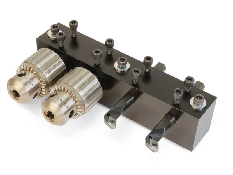

We designed our gang-tooling tool post specifically for our customers who want to convert their Sherline lathe into a “Chucker Lathe” or gang-tooling lathe. This tool post will also be the standard tool post that we will offer with our CNC Chucker Lathe.

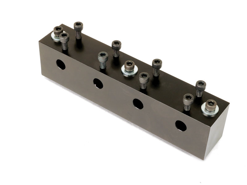

Our gang-tooling tool post offers a convenient and accurate way to hold up to four tools with a known centerline-to-centerline distance of 1.500″. This tool post has (4) 3/8″ holes to hold boring bars, drill chucks, or tool bushings with two locking screws for each tool.

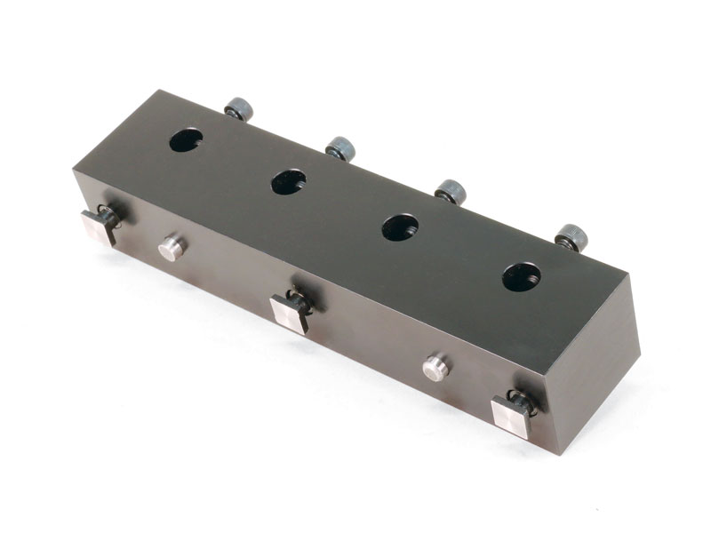

  • 3/8″ Gang-Tool Post Body
  • 10-32 x 1″ SHCS (3)
  • Extended Tool-Post T-Nut (3)
  • 10-32 x 3/4″ SHCS (8)
  • #10 Washer (3)

Tool Post Body MaterialAluminum
Body CoatingBlack Anodized
Body Dimensions (H x W X D)1.4375″ x 6.25″ x 1.1875″
Tool Holes1.5″ between centers
Part No.DescriptionQuantity
593013/8″ Gang-Tool Post Body1
4034010-32 x 1″ SHC Screw3
40250Extended Tool-Post T-Nut3
4069010-32 x 3/4″ SHC Screw8
40660#10 Washer3
59303Steel Dowel Pin 1/4″ x 3/4″2
