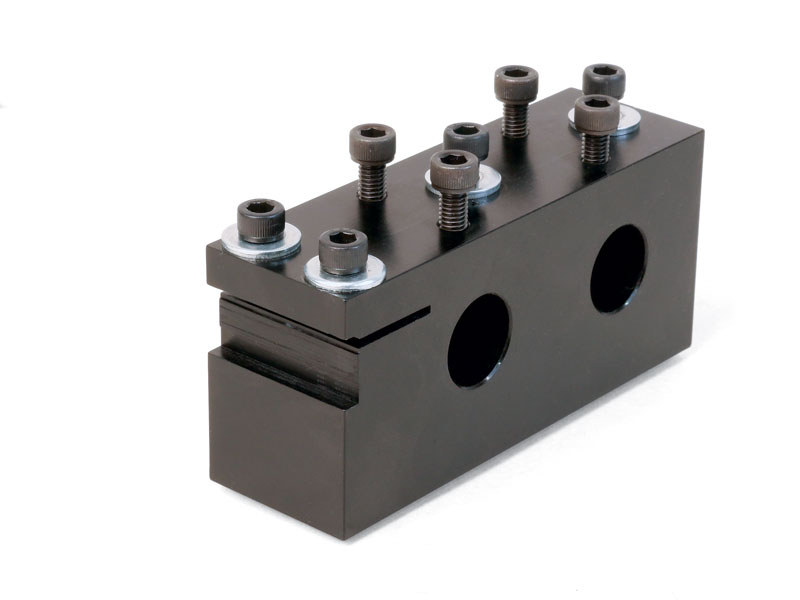

About the 5/8″ Rear Side Cutoff Multi-Tool Holder

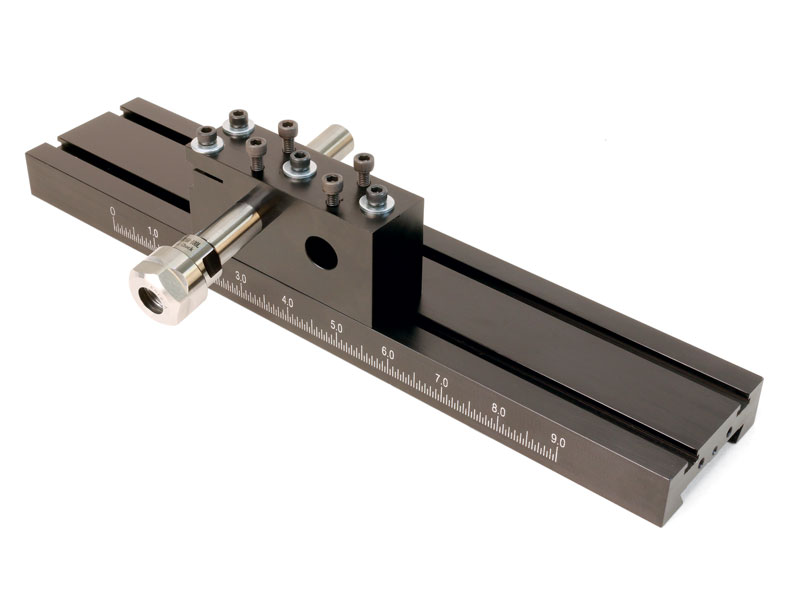

The rear side cutoff, multi-tool holder was designed to complement our four-position, gang-tooling tool posts. It can be used in conjunction with the gang-tooling tool post, or on its own for our customers who want to convert their Sherline lathe into a “Chucker Lathe” or gang-tooling lathe.

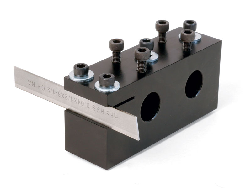

Our rear side cutoff, multi-tool holder offers a convenient and accurate way to hold up to two, round boring tools with a known center-line-to-center-line distance of 1.500″, and a slot for holding a cutoff tool blade.
Includes the following:
  • 5/8″ Rear Side Cutoff Multi-Tool Post Body
  • 10-32 x 1″ SHCS (2)
  • 10-32 x 3/4″ SHCS (6)

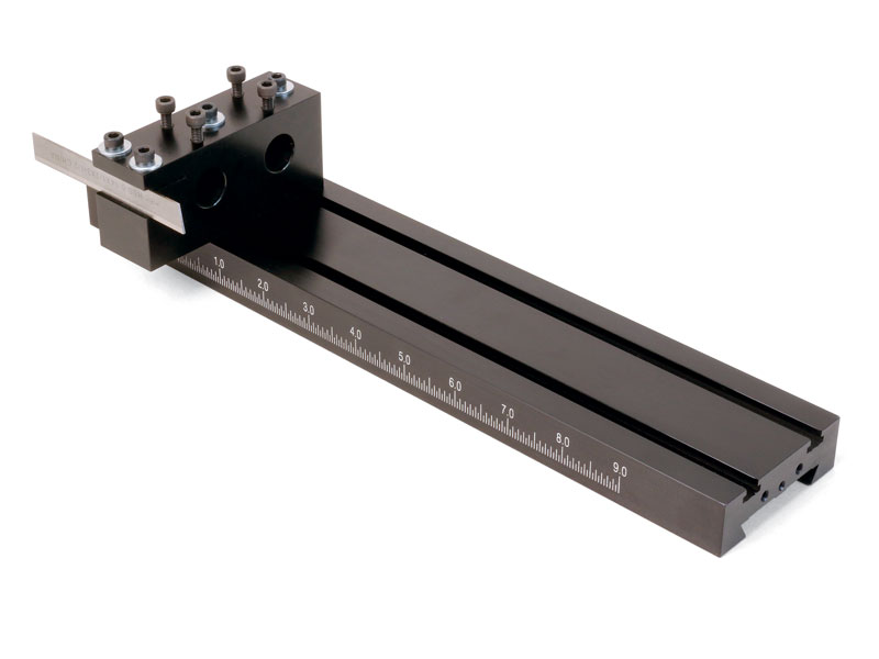

Using the Part-Off Tool
This holder can be mounted as shown in Figure 1, so the blade is in front of the crosslide. This will allow you to cut off larger diameter parts as long as the section to be parted off does not exceed 1.0” in length (the distance between the back of the part-off blade and the front of the crosslide).
FIGURE 1—The distance from the back of the part-off blade to the front of the crosslide is 1.0″ when the tool holder is perpendicular to the crosslide. Click on the image for a larger view.
