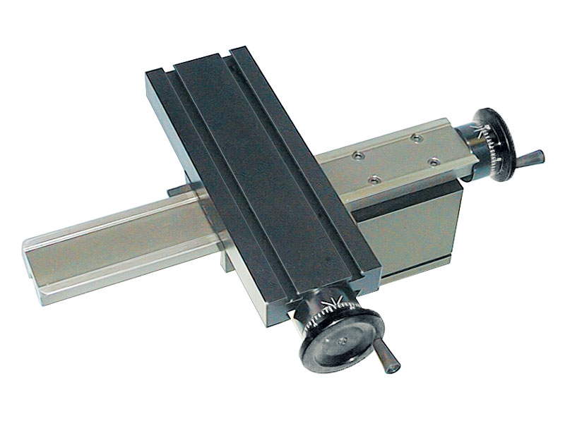

About the 2-Axis Manual Machine Slides
  1. The slides are manufactured primarily from 6061-T6 aluminum and finished with a black anodizing. The slides that incorporate steel parts have ground dovetails.
  2. The table is 8″ x 2.75″, and any table is available with either an inch or metric leadscrew.
  3. Leadscrews are precision rolled from steel, and table screws are located under the table, out of the way of chips. Leadscrew backlash is adjustable.
  4. Dovetailed tables and saddles have adjustable gibs to eliminate play.
  5. 2″ Industrial handwheels are graduated in .001″ increments on inch slides and in .01 mm increments on metric slides.
