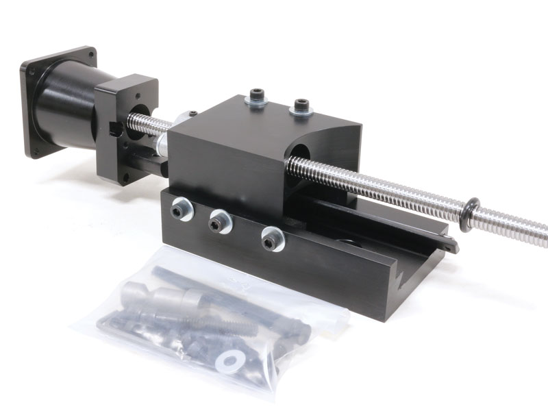

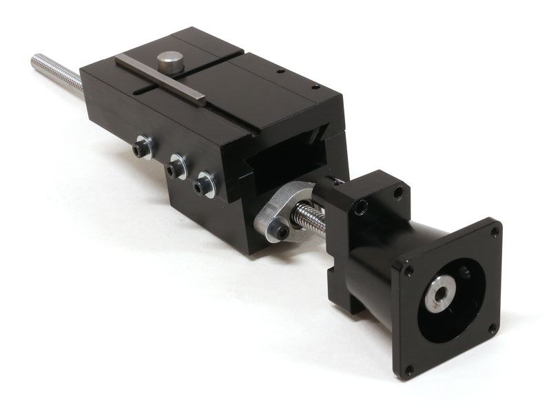

The key upgrade parts for this ball screw retrofit kit include a ball leadscrew, stepper motor high-torque coupling, vertical milling column saddle for ball screws, and column saddle Z-axis ball nut mount.
Ball Leadscrew Specifications
  • 10mm Diameter, 2mm Lead
  • C7 Accuracy*, P1 Preload
SPECIAL NOTE ON THE COLUMN BED: The new column saddle on the Z-axis is longer, and the headstock mounts towards the bottom of the saddle. We did this because the column saddle Z-axis ball nut mount (P/N 45046) would not allow the original saddle to move low enough to the top of the mill table. Additionally, the P/N 45046 reduces the overall amount of usable Z-axis travel, and the maximum clearance above the table will be 2″ less than that of a standard leadscrew machine. In order to achieve greater travel and clearance above the table, we suggest that you upgrade to the 15″ Extended Mill Column Bed (P/N 45261) if you are ordering a new machine or doing a mill ball screw retrofit. The 15″ extended column bed makes up for the loss of travel in the Z-axis. It is also available with an electroless nickel/Teflon plating (P/N 45265) that adds increased lubricity and rust prevention.
Regarding Retrofits
  1. The charge for all ball leadscrews is the same, regardless of the overall length. This is because the manufacturer does not give us a price break on the shorter screws (in fact, they wanted more for a 6″ ball screw). All screws come in at 400mm (15.75mm) long, and we cut them to length to fit the individual machine axis.
  2. All retrofits come with the stepper-motor mount, high-torque coupling, bearings, preload nut, and ball screw fully assembled in our factory. We do not sell these parts individually for you to assemble.
  3. The ball leadscrew and the rest of the assembly are assembled and checked in our factory. We place an O-ring on the end of the ball screw below the saddle, away from the motor mount. The O-ring is placed there to help ensure that the ball nut does not thread itself off the ball screw. If the ball nut threads off the ball screw, the balls in the ball nut will come out. At this point, the ball screw is scrap. There is no way to fix it! For this reason, the O-ring is to remain on the ball screw until the ball screw assembly is fully assembled on your machine. After you have assembled your ball screw on your machine, you may remove the O-ring.
    NOTE: On retrofits, the only way your ball leadscrew can have excessive slop (backlash) is if some of the balls have come out of the ball nut. We will not replace ball leadscrews that have excessive slop (backlash)!
  4. If you are using a headstock riser block on your machine we strongly recommend upgrading your pivot pin and riser block to the AP Mill Extended Pivot Pin P/N 50240AP with the AP Headstock Riser Block P/N 12950AP. This pivot pin increases the rigidity and strength of your headstock to column assembly. Note: Your existing riser block P/N 12950 can be machined to allow the new pivot pin to go all the way through the riser block. Either drill or mill the top section of the pivot pin hole to .501”+-.001 (12.73mm) for clearance. See print below:
