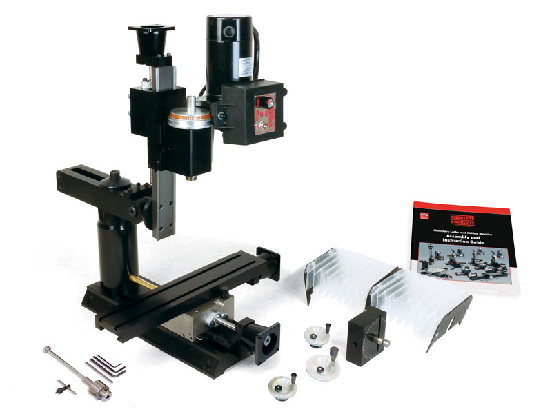

About the 14″ Base CNC-Ready Mill with Ball Screws
This machine is based on our 14″ 2000-series mill. The 14″ mill base with ball screws comes with all-new saddles developed for the ball screws and #23 NEMA frame stepper-motor mounts with high-torque couplings.
The X/Y-mill saddle has been beefed up to accommodate the larger ball screws, and it has an electroless nickel/Teflon coating. This coating offers a hard surface that is rustproof, while the Teflon provides a friction coefficient of .1-.2u for smoother movement of the saddle and the table.
L: 2000 w/standard leadscrew
R: 14″ ball leadscrew mount
The Z-axis column bed on the 14″ ball screw mill is mounted directly to the swing arm with an arm mount, unlike the 2000 Deluxe mill that utilizes a movable clamping disk. This effectively eliminates the side-to-side rotational axis of the column bed.
SPECIAL NOTE ON THE COLUMN BED: The new column saddle on the Z-axis is longer, and the headstock mounts towards the bottom of the saddle. We did this because the column saddle Z-axis ball nut mount (P/N 45046) would not allow the original saddle to move low enough to the top of the mill table. Additionally, the P/N 45046 reduces the overall amount of usable Z-axis travel, and the maximum clearance above the table will be 2″ less than that of a standard leadscrew machine. In order to achieve greater travel and clearance above the table, we suggest that you upgrade to the 15″ Extended Mill Column Bed (P/N 45261) if you are ordering a new machine or doing a mill ball screw retrofit. The 15″ extended column bed makes up for the loss of travel in the Z-axis. It is also available with an electroless nickel/Teflon plating (P/N 45265) that adds increased lubricity and rust prevention.

Standard equipment for the model 6820 CNC-ready mill includes:
  • 14″ base
  • Accordion way cover
Download PDF 6820 Exploded View
