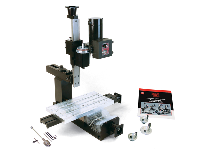

About the 18″ Base CNC-Ready Mill with Ball Screws
This machine is based on our 18″ NexGen 5800-series mill. The 18″ mill base with ball screws comes with all-new saddles developed for the ball screws and #23 NEMA frame stepper-motor mounts with high-torque couplings.
The X/Y-mill saddle has been beefed up to accommodate the larger ball screws, and it has an electroless nickel/Teflon coating. This coating offers a hard surface that is rustproof, while the Teflon provides a friction coefficient of .1-.2u for smoother movement of the saddle and the table.
The new ball screw design for the column saddle reduces the overall Z-axis travel by 1.4″. Because the ball nut does not allow the column saddle to move down as far as the old style column saddle, we made the new ball screw column saddle longer. This will allow you to move the headstock closer to the top of the mill table. However, you will still lose 1.4″ of overall travel in the Z-axis.
L: 5800 w/standard leadscrew
R: 18″ ball leadscrew mount
The Z-axis column bed on the 18″ ball screw mill is mounted directly to the swing arm with an arm mount, unlike the 5800 NexGen mill that utilizes a movable clamping disk. This effectively eliminates the side-to-side rotational axis of the column bed.
The Axes of Movement of a Sherline 6858 Ball Screw Mill
Ball Leadscrew Specifications
  • 10mm Diameter, 2mm Lead
  • C7 Accuracy*, P1 Preload
Standard equipment for the model 6858 CNC-ready mill includes:
  • 18″ base
  • 7″ x 13″ tooling plate with three T-slots
  • 15″ mill column bed with nickel/Teflon coating
  • The handwheels are included and can be mounted to the end of the stepper motors to maintain manual control when needed.* 2-1/2″ (63mm) adjustable “zero” handwheel on the Z-axis and 2″ (51mm) adjustable “zero” handwheels on the X- and Y-axes. Each handwheel has laser-engraved aluminum handwheel collars
  • Accordion way cover
