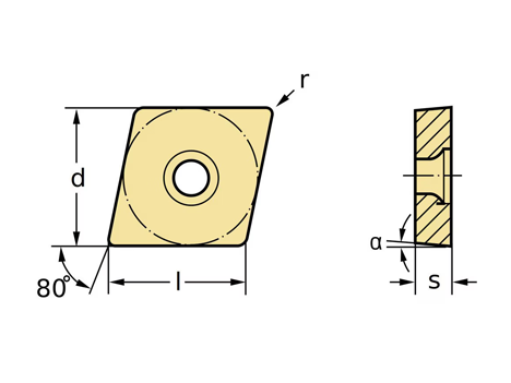

INSCRIBED CIRCLE | 0.250″ (6.35 MM) |
CUTTING EDGE LENGTH | 0.254″ (6.45 MM) |
INSERT THICKNESS | 0.094″ (2.38 MM) |
CLEARANCE ANGLE MAJOR | 11° |
INCLUDED ANGLE | 80° |
ISO INSERT DESIGNATION | CPMT 21.51 |
CORNER RADIUS | 0.016″ (0.4 MM) |
MINIMUM FEED PER REVOLUTION | 0.002″ (0.05 MM) |
MAXIMUM FEED PER REVOLUTION | 0.006″ (0.16 MM) |
DEPTH OF CUT MINIMUM | 0.004″ (0.1 MM) |
MAX DEPTH OF CUT | 0.059″ (1.5 MM) |
