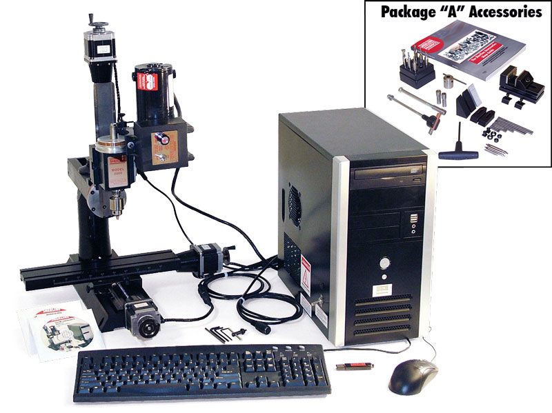

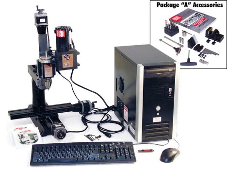

About the Sherline CNC 8-Direction Benchtop Mill
Our CNC benchtop mill is perfect for the customer looking for a mini CNC milling machine to make small, precision parts. The deluxe 8-direction milling machine offers the most versatility of any Sherline mill. In addition to X-axis, Y-axis, and Z-axis travels, there are five additional directions that the headstock spindle can be positioned to do drilling or milling on your part from virtually any angle.
All our CNC milling machines are made in the USA, and our customer service is second to none. Although our machines are small, they can produce high-quality precision parts. Our CNC mill will not only cut wood and plastic but is also rigid and accurate enough to cut aluminum and steel parts. This mill is a desktop-size machine with full-size machine precision and accuracy.
  • 8-Direction Benchtop CNC Milling Machine fitted with saddle oiler, stepper motor mounts, and couplers on X-, Y-, and Z-axes
  • A computer with Ubuntu Linux-based OS with LinuxCNC 4-axis CNC software preinstalled
  • Keyboard and mouse
  • A blank 4GB USB flash drive
You supply only a monitor.
Standard equipment for the CNC 8-Direction Benchtop Mill includes:
  • 14″ base
  • 2″ column riser block
  • Laser-engraved scales on the base and table
A-Package Accessories Include:
  • Step block hold-down set
  • 5/32″ Sherline hex T-driver
  • 3-piece center drill set
  • Fly cutter w/carbide bit
  • 6-piece 3/8″ 2-flute double-ended end mill set
    (P/N 7401 4-flute set may be substituted depending on availability)
  • 3/8″ end mill holder
  • Milling vise
