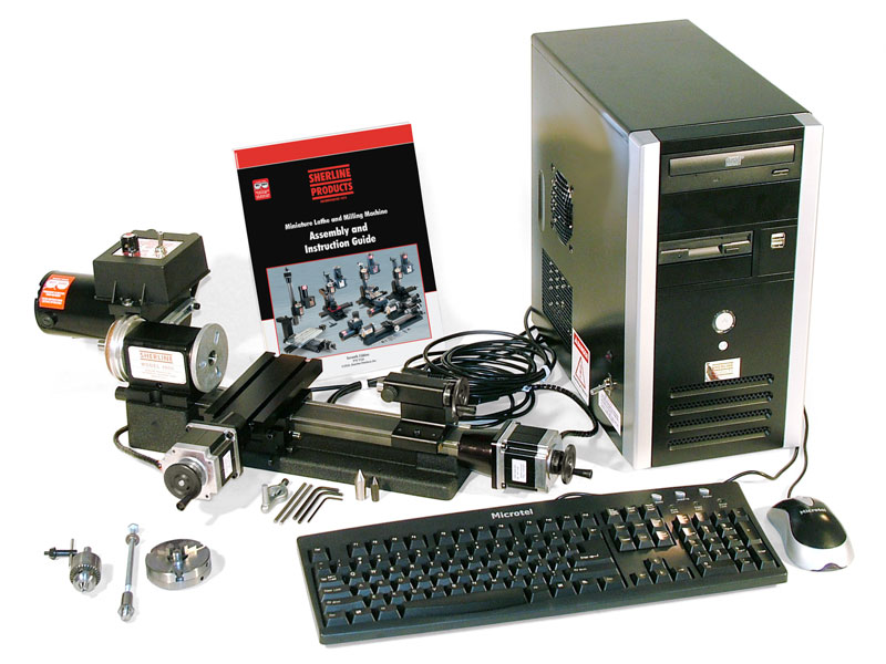

Our CNC tabletop lathe is perfect for the customer looking for a mini CNC lathe to make small, precision parts. All our lathes are made in the USA, and our customer service is second to none. Although our machines are small, they can produce high-quality precision parts. Our CNC lathe will not only cut wood and plastic but is also rigid and accurate enough to cut aluminum and steel parts. This lathe is a desktop-size machine with full-size machine precision and accuracy.
The CNC Tabletop Lathe Package includes:
  • 8″ tabletop lathe with two stepper motors fitted to stepper motor mounts on the leadscrew and crosslide axes (The tailstock spindle remains manually controlled)
  • Keyboard and mouse
You supply only a monitor.
Standard equipment for the CNC Tabletop Lathe includes:
  • Three standard 1-5/8″ (41mm) laser-engraved aluminum handwheels mounted on the stepper motors and tailstock. Each handwheel has laser-engraved aluminum handwheel collars
The A Package Includes:
Download PDF DRO Instructions
Swing Over Bed3.50″ (90 mm)
Spindle Nose Taper#1 Morse
Length Overall23.5″ (597 mm)
Width Overall10.5″ (267 mm)
Height Overall8.5″ (216 mm)
Shipping Weight63 lb. (28.6 kg)
Motor90 volt DC with electronic speed control that accepts any incoming current from 100 VAC to 240 VAC, 50 Hz or 60 Hz.
CNC stepper motor holding torque136 oz-in
Maximum CNC travel speed, X and Z22 inches/min
