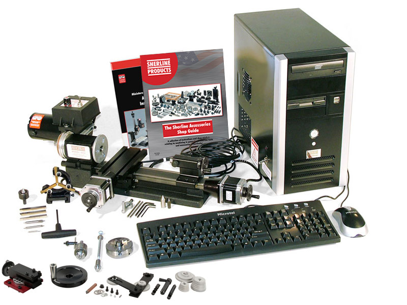

Our CNC tabletop lathe is perfect for the customer looking for a mini CNC lathe to make small, precision parts. All our lathes are made in the USA, and our customer service is second to none. Although our machines are small, they can produce high-quality precision parts. Our CNC lathe will not only cut wood and plastic but is also rigid and accurate enough to cut aluminum and steel parts. This lathe is a desktop-size machine with full-size machine precision and accuracy.
The CNC Tabletop Lathe Package includes:
  • 8″ tabletop lathe with two stepper motors fitted to stepper motor mounts on the leadscrew and crosslide axes (The tailstock spindle remains manually controlled)
  • Keyboard and mouse
You supply only a monitor.
Standard equipment for the CNC Tabletop Lathe includes:
  • Three standard 1-5/8″ (41mm) laser-engraved aluminum handwheels mounted on the stepper motors and tailstock. Each handwheel has laser-engraved aluminum handwheel collars
The C Package includes:
  •  2.5″ 3-jaw self-centering chuck
  • Steady rest
  • Live Center
  • 5/32″ T-driver
  • 3-pc Center Drill Set
  • Thread Cutting Attachment
  • Compound Slide
