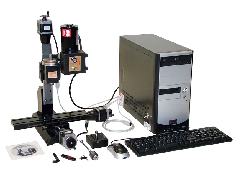

About Sherline CNC Tabletop Mills
Our CNC tabletop mill is perfect for the customer looking for a mini CNC milling machine to make small, precision parts. All our milling machines are made in the USA, and our customer service is second to none. Although our machines are small, they can produce high-quality precision parts. Our CNC mill will not only cut wood and plastic but is also rigid and accurate enough to cut aluminum and steel parts. This mill is a desktop-size machine with full-size machine precision and accuracy.
  • Deluxe Tabletop CNC Milling Machine fitted with saddle oiler, stepper motor mounts, and couplers on X-, Y- and Z-axes
  • Keyboard and mouse
  • A blank 4GB USB flash drive
You supply only a monitor.
Standard equipment for the CNC 12″ Deluxe Tabletop Mill includes:
  • 12″ base
  • Headstock spacer block
Download PDF 12″ Mill Base Dimensions
Max clearance
(table to spindle)
8.00″ (203 mm)
Throat
(no spacer)
2.25″ (50 mm)
Throat
(w/ headstock spacer)
Included, 3.50″ (89 mm)
Travel, “X” Axis8.65″ (220 mm) (9″ (228 mm) w/stop screw removed)
Spindle nose taper#1 Morse
Width Overall*15.00″ (381 mm)
Depth Overall*Base footprint: 17.625″ (448 mm); With fully extended brass leadscrew cover: 20.5″ (520 mm)
Hold-down provision2 T-Slots
Shipping Weight40 lb. (18.2 kg)
Movements in addition
to X-, Y- and Z-axes
CNC Stepper motor holding torque136 oz-in
Maximum CNC travel positioning speed, X, Y and Z axes22 inches/min**
