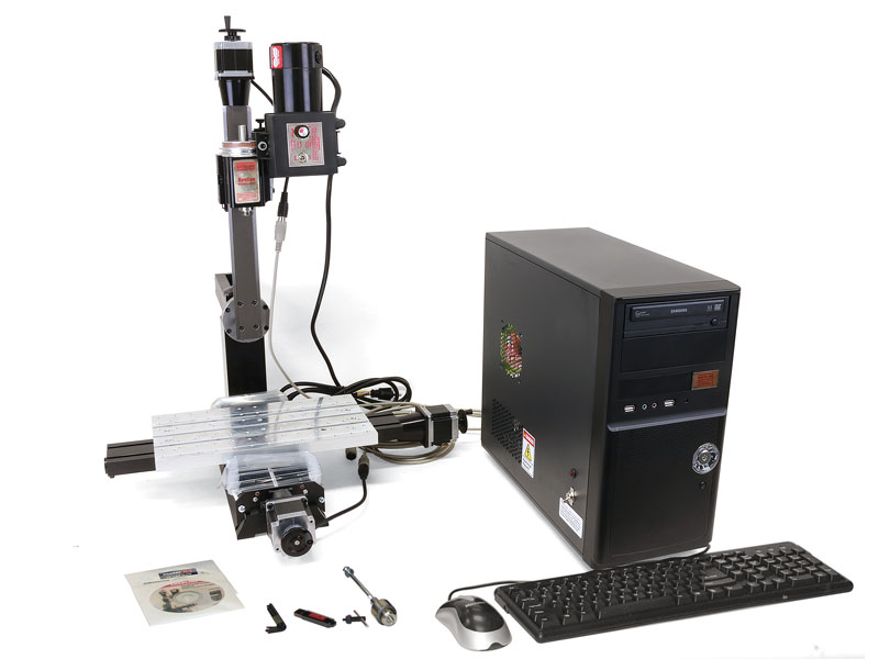

About the Sherline CNC NexGen Benchtop Mill
Our CNC benchtop mill is perfect for the customer looking for a mini CNC milling machine to make small, precision parts. The NexGen milling machine offers three directions of travel, and there are four additional directions that the headstock spindle can be positioned to do drilling or milling on your part from virtually any angle.
All our CNC milling machines are made in the USA, and our customer service is second to none. Although our machines are small, they can produce high-quality precision parts. Our CNC mill will not only cut wood and plastic but is also rigid and accurate enough to cut aluminum and steel parts. This mill is a desktop-size machine with full-size machine precision and accuracy.
  • NexGen Benchtop CNC Milling Machine fitted with saddle oiler, stepper motor mounts, and couplers on X-, Y-, and Z-axes
  • A computer with Ubuntu Linux-based OS with LinuxCNC 4-axis CNC software preinstalled
  • Keyboard and mouse
  • A blank 4GB USB flash drive
You supply only a monitor.
Standard equipment for the CNC NexGen Benchtop Mill includes:
  • 2.75″ (70 mm) x 18.0″ (457 mm) extended mill table with two T-slots
  • 7″ x 13″ tooling plate
  • 15″ (63mm) extended column bed
  • Extra-rigid column base
  • Oil reservoirs on the X-, Y- and Z-axes
