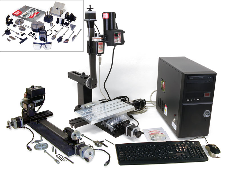

Sherline’s Ultimate CNC Machine Shop comes complete with a CNC-ready lathe and vertical milling machine, plus the stepper motors, computer, software, and cables to run them.
The NexGen Ultimate CNC Machine Shop system includes the following:
  • Deluxe 3.5″ x 17″ Benchtop Lathe with two stepper motors, in either inch or metric measurements
  • 18″ NexGen Benchtop Vertical Mill with three stepper motors, in either inch or metric measurements
  • Handwheels on the rear shafts of the stepper motors also allow manual control
  • Rotary table with stepper motor (for use as a 4th axis on the mill) and the computer
  • A computer with Ubuntu Linux-based OS with linuxcnc 4-axis CNC software preinstalled
  • Keyboard and mouse
  • 4-axis driver board and power supply installed inside the computer to run either the mill or lathe, one at a time
You supply only a monitor.
