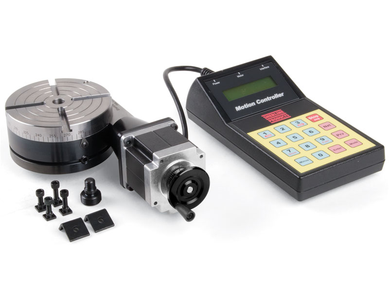

Sherline has advanced its precision 4″ rotary table into the 21st century with the addition of Computer Numerical Control (CNC). This upgrade makes it an ideal solution for clockmakers, gear cutters, and anyone needing to machine intricate radially symmetrical patterns. The CNC rotary table takes the complexity out of repetitive indexing tasks.
Complete, Stand-Alone System
4″ Sherline rotary table with pre-installed stepper motor
Microprocessor unit with numeric keypad
115 VAC power supply (universal 110–240 VAC compatible)
All required connecting cables
Mounting Options
Right-Angle Attachment: Holds the table vertically at a 2.7″ center height. A matching right-angle tailstock is also available for supporting long workpieces.
Tilting Angle Table: Allows mounting at any angle from 0° to 90°. At 90°, the center height remains 2.7″, compatible with the right-angle tailstock.
Simple, Accurate Operation
Resolution: 28,800 steps per revolution
Accuracy: ±0.006° per step
Flexible Integration

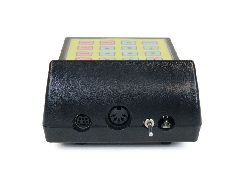

Accepts input signals from an external CNC controller
Sends “completion” signals back to the master controller
Can be daisy-chained with other units for coordinated actions
Horizontal orientation: 50 lbs
Vertical orientation: 30 lbs
Vertical rotational torque: 6 ft-lbs (e.g., able to lift a 6 lb. weight 12″ from the center)
