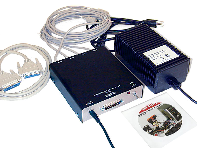

When Sherline developed the CNC system for the mill, we installed the drivers and power supply inside the computer box as a complete package. For those who wish to run the stepper motors on their Sherline CNC-ready machines using a computer other than the one supplied as part of Sherline’s lathe and mill CNC systems, we now offer the driver box and power supply as a separate item.
The anodized aluminum box contains four drivers. Each driver outputs to its own cable, labeled X, Y, Z, and A, that plugs directly into Sherline’s stepper motors. These stepper motors are pre-wired with a plug to match that on the end of the driver box cables, making hookup easy and fast. A 25-pin parallel cable (included) runs from the box to the parallel port on a computer* that you supply. Power comes from an external power supply (included) that plugs into the box. Also included is a DVD containing the correct version of the Linux operating system and LinuxCNC control program that Sherline uses in its CNC system, should you wish to install them on your own computer*. The operating instructions for CNC and a short course in writing G-code by Joe Martin are also included. The driver box has its own power on/off switch and a bright red LED that indicates when power is on. It operates on either 110 or 220 VAC power (switchable).
*NOTE: Dell computers seem to have a lot of difficulties with the Linux OS installation.

  • 25-pin parallel cable*
  • Two spare fuses
*NOTE: A 25-wire parallel port is required because EMC2 is designed to run up to six axes simultaneously. Even though the Sherline driver box only uses four of those axes at one time, a 2-wire serial USB port cannot transmit data to multiple axes fast enough for glitch-free CNC operation.
