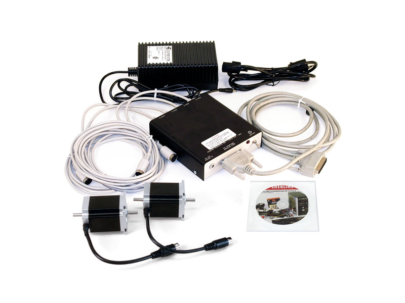

If you wish to purchase a Sherline CNC lathe but want to use your own computer and software instead of Sherline’s computer with pre-loaded Linux/EMC software, this package makes it easier. Here’s what you do:
  1. Order the CNC-ready lathe of your choice.
  2. Order this kit (4-axis driver box, connecting cables, power supply, and two high-torque stepper motors). The high-torque stepper motor has the same NEMA #23 frame as our standard stepper motor, but it has over 75% more torque. For more information on the high-torque stepper motors, CLICK HERE.
This kit includes Sherline’s 4-axis driver box, power supply, and two high-torque stepper motors. Plug the 25-pin parallel cable (included) from the driver box to your computer’s printer port. Attach the stepper motors to the stepper motor mounts on the crosslide and leadscrew of your Sherline CNC-ready lathe, and plug the X and Z cables from the driver box to the stepper motors. You are ready to go once you select and install your own control software.
NOTE: If you want a complete plug-and-play system with a lathe or mill, computer, and driver ready to run, see the complete CNC systems listed elsewhere on this site

  • 25-pin parallel cable*
  • Two spare fuses
