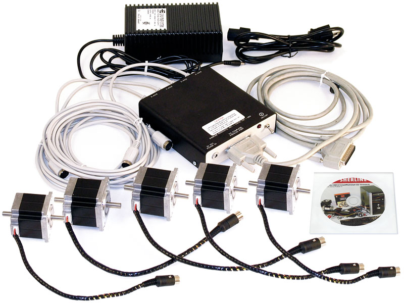

If you wish to purchase a Sherline CNC Machine Shop Package, but you want to use your own computer and software instead of Sherline’s computer with pre-loaded Linux/EMC software, this package makes it easier. Here’s what you do:
  1. Order the CNC-ready machine shop package of your choice.
  2. Order this kit (4-axis driver box and connecting cables plus power supply and 5 stepper motors)*.
This kit includes Sherline’s 4-axis driver box and power supply plus five stepper motors. Plug the 25-pin parallel cable (included) from the driver box to the printer port of your computer. Attach the stepper motors to the stepper motor mounts on the crosslide and leadscrew of your Sherline CNC-ready lathe mill and plug the X and Z cables from the driver box to the stepper motors, or on the on the X, Y and Z axes of your Sherline CNC-ready mill and plug the X, Y and Z cables from the driver box to the stepper motors. Once you select and install your own control software, you are ready to go.

uc100Use your own laptop or desktop via the USB port with Sherline’s CNC Controller. New from DPP Engineering is this new USB CNC to LPT motion controller. This product contains a microprocessor which simulates a complete CNC controller program and thus elevates the processing load from the host computer.
