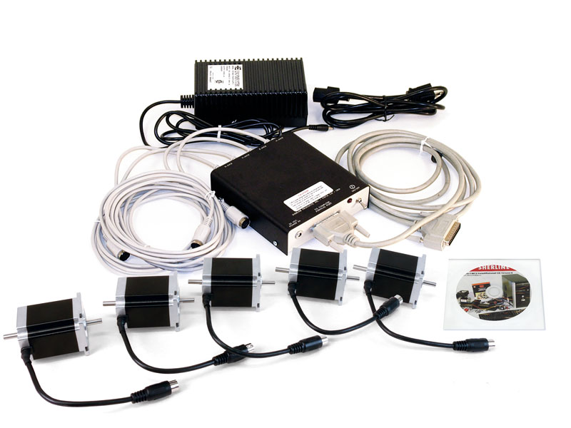

If you wish to purchase a Sherline CNC Machine Shop Package but want to use your own computer and software instead of Sherline’s computer with pre-loaded Linux/EMC software, this package makes it easier. Here’s what you do:
  1. Order the CNC-ready machine shop package of your choice
  2. Order this kit (4-axis driver box, connecting cables, power supply, and five high-torque stepper motors). The high-torque stepper motor has the same NEMA #23 frame as our standard stepper motor, but it has over 75% more torque. For more information on the high-torque stepper motors, CLICK HERE.
This kit includes Sherline’s 4-axis driver box and power supply plus five high-torque stepper motors. Plug the 25-pin parallel cable (included) from the driver box to your computer’s printer port. Attach the stepper motors to the stepper motor mounts on the crosslide and leadscrew of your Sherline CNC-ready lathe, and plug the X and Z cables from the driver box to the stepper motors. You are ready to go once you select and install your own control software.

  • 25-pin parallel cable*
  • Two spare fuses
