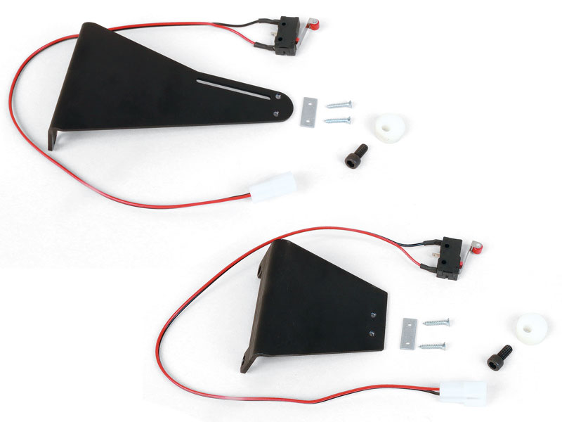

Limit Switch Assembly for Leadcrew Lathe
Includes:
  • Limit switch (with pigtail and connector)
  • Limit switch mounting hardware
About the limit switches and mounts
You may connect the limit switches to Acorn or any other controller configured to work with our limit switches.
To retrofit some of our limit switch mounts, one or two holes must be drilled and tapped on your machine.
NOTE: Click the Instructions tab above for information on mounting holes and instructions on modifying your accordion way cover (leadscrew mills only).
