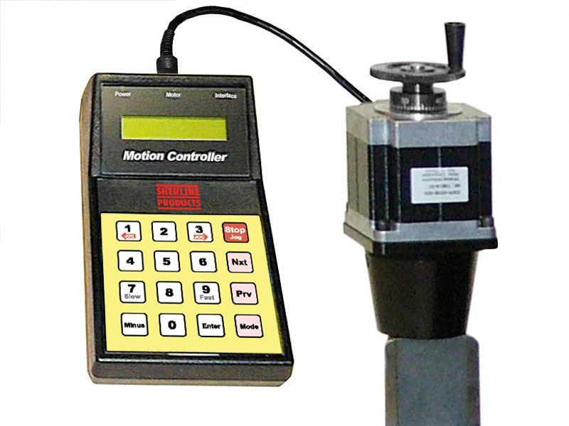

This stand-alone controller is programmable from its keypad and controls the stepper motor’s function to which it is attached.
An 8-pin mini-DIN cable can be used to connect multiple units in a “daisy chain.” The units can signal each other to work in sequence, allowing multiple movements to be accomplished without using a computer or master CNC controller. They can also be used in conjunction with existing CNC controllers. The controller is user-programmable with two separate programs of up to 40 operations each. In each block, you can control distance, direction, speed, and whether the program pauses or proceeds to the next block.
The linear controller can also be “daisy-chained” with Sherline’s rotary controller to achieve rotary and linear movement combinations. This makes it easy to set up for relatively sophisticated operations like cutting gears without having to know anything about CNC programming beyond what is entered from these simple keypads.

This kit upgrades the X- or Y-axis of a manual Sherline milling machine or the crosslide of a Sherline lathe for use with a CNC linear controller. It includes a CNC linear controller and all the components required to convert a manual axis to CNC operation. The linear controller comes with a stepper motor mount for machines that are not CNC-Ready.
The stand-alone controller is programmable via its integrated keypad and controls the attached stepper motor, which can be mounted on the mill’s X- or Y-axis or the lathe’s crosslide. (For lathe leadscrew upgrades, click here for 15" upgrade kits or click here for 24" kits.)
An 8-pin mini-DIN cable allows multiple controllers to be connected in a "daisy-chain" configuration. Controllers can signal one another to run in sequence, enabling complex, multi-axis movements without a computer or master CNC controller. The controller also integrates easily with existing CNC systems. Each controller stores two independent programs with up to 40 steps per program. Each step can define travel distance, direction, feed rate, and whether the sequence pauses or continues automatically.
The linear controller can also be daisy-chained with Sherline’s rotary controller (P/N 8700), allowing combined rotary and linear motion for advanced operations—such as gear cutting—without the need for CNC programming skills beyond simple keypad inputs.
