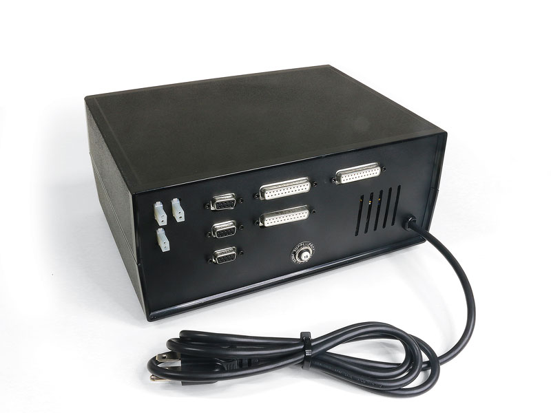

The Sherline/Acorn CNC control (P/N 9400) comes in a custom housing with all the desired components inside and all necessary connections on the front and rear panels. This custom control housing has the Acorn board and the relay card mounted inside. It includes all the wiring for the DB9, DB25, 2-wire Molex connectors, the Ethernet connection, the power supply, the circuit breaker, and the cooling fan.

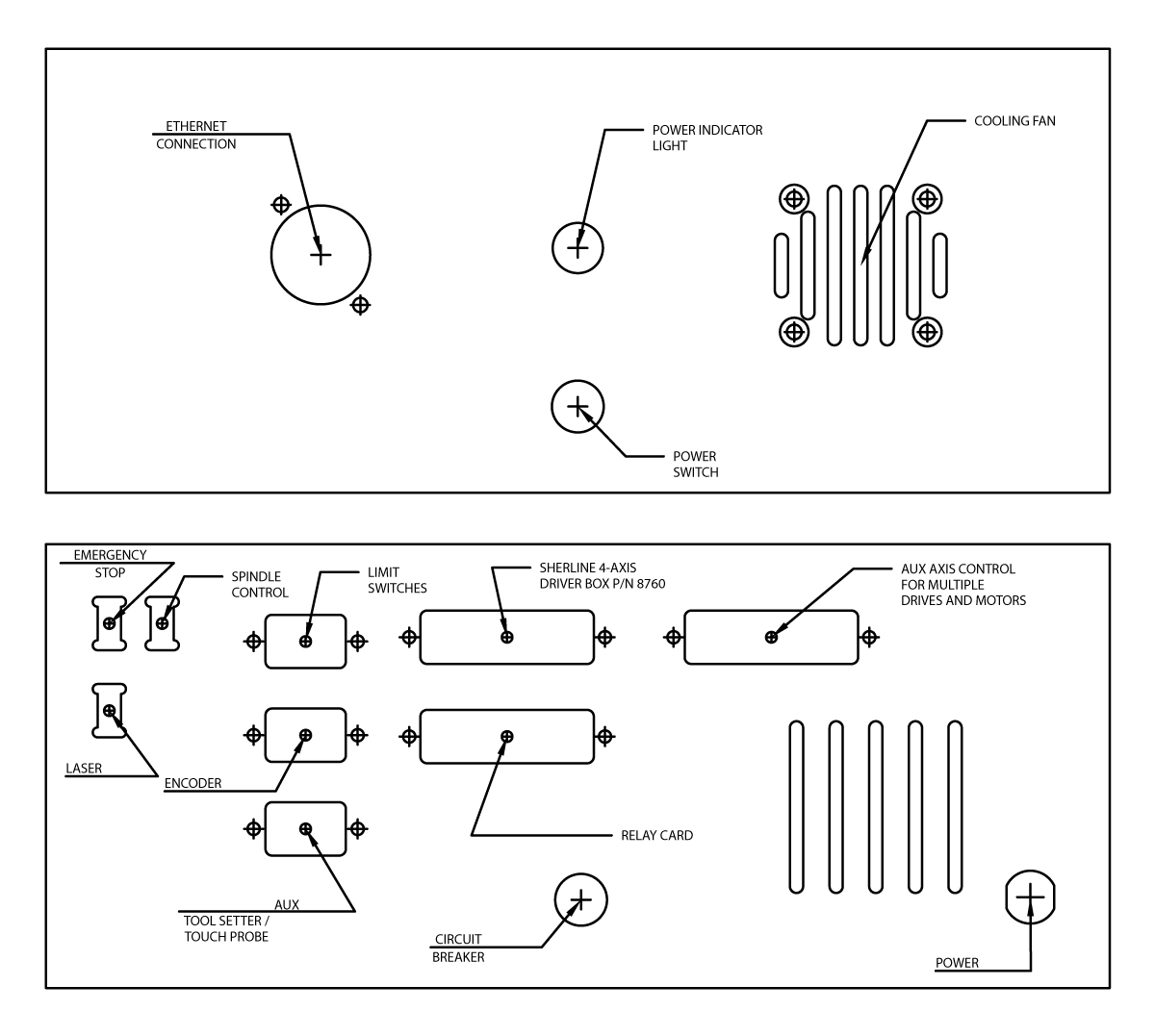

The components and connections on the front control panel:
  • Ethernet connection
  • Power switch and power LED light
  • Cooling fan
The connections on the back control panel:
  • Three DB25 connectors for 1) Sherline 4-axis Driver Box, 2) Aux 4-axis Control for multiple drives, stepper or servo motors, 3) The relay card
  • Three DB9 connectors for 1) Limit switches, 2) External Encoder*, 3) Aux Tool Setter or Touch Probe (only one can be connected, not both)
    *Download the Sherline/Acorn Spindle Speed-Control information
  • Three 2-wire Molex connectors for 1) E-stop button, 2) Spindle control, 3) Laser
