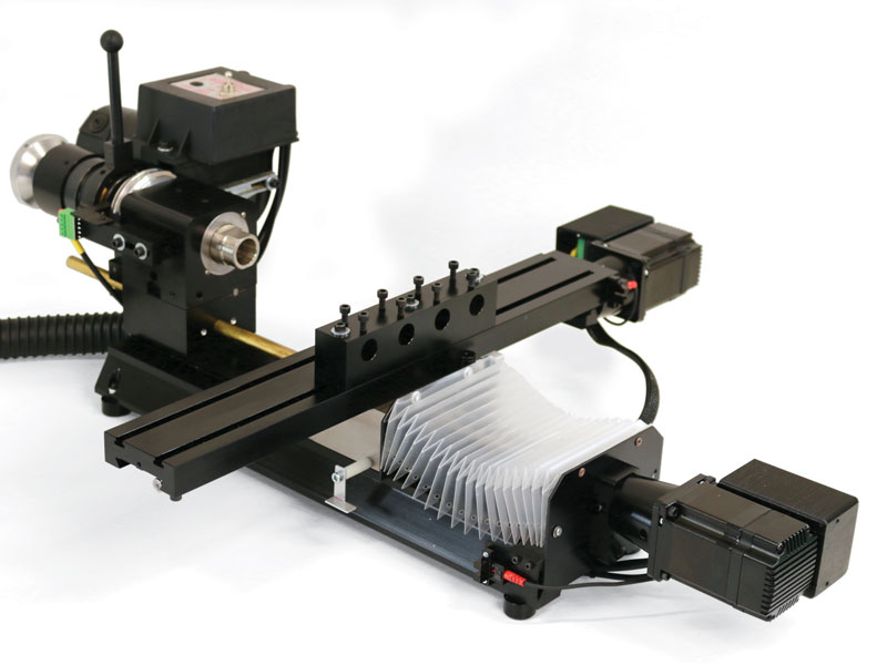

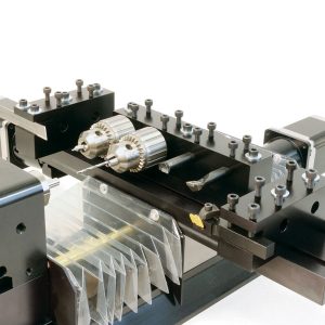

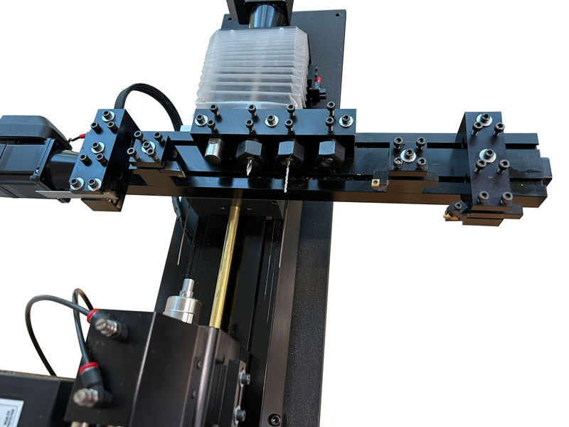

We designed our Accu-Pro chucker lathe for our industrial customers who want the convenience of using multiple tools in a single setup. The chucker lathe has an 18″ aluminum base, an 18″ crosslide that accommodates the 3/8″, or 5/8″ gang-tooling tool posts, optional tool posts (tools not included), 36V closed-loop stepper motors with #23 NEMA frames, motor mounts with high-torque couplings, and C5 bearings in the headstock for smoother spindle operation.
This machine is perfect for the customer looking for a benchtop or tabletop machine for making small, precision parts. Our machines are made in the USA, and our customer service is second to none. We have sold many of these machines to medical and high-tech companies and have received great feedback. Although our machines are small, they are capable of producing the same high-quality precision parts that are made on a full-size machine.

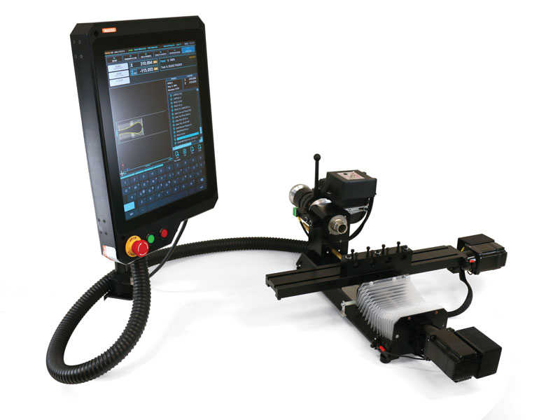

The MASSO Touch Controller with power supply and spindle drive card lets you input data to the controller via a state-of-the-art touch screen. With MASSO, you can write your CNC programs on your computer (Windows, Mac, Linux, etc.) and then transfer your program to the controller via a USB flash drive. You no longer have to use a dedicated operating system like Linux or Mach 4 to control your machine.
The Touch Controller includes:
  • Industrial cable system from the controller to the machine
  • 36-volt power supply
  • Touch-controller stand

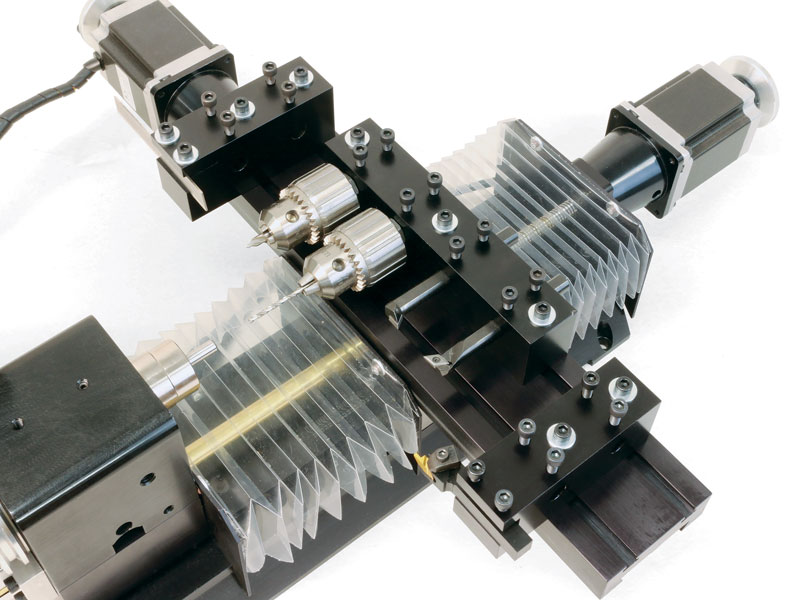

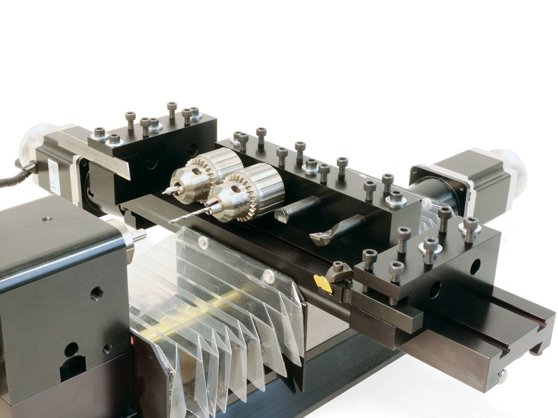

  • Your choice of gang-tooling tool posts that hold up to four tools: 3/8″ (P/N 5930) or 5/8″ (P/N 5935)

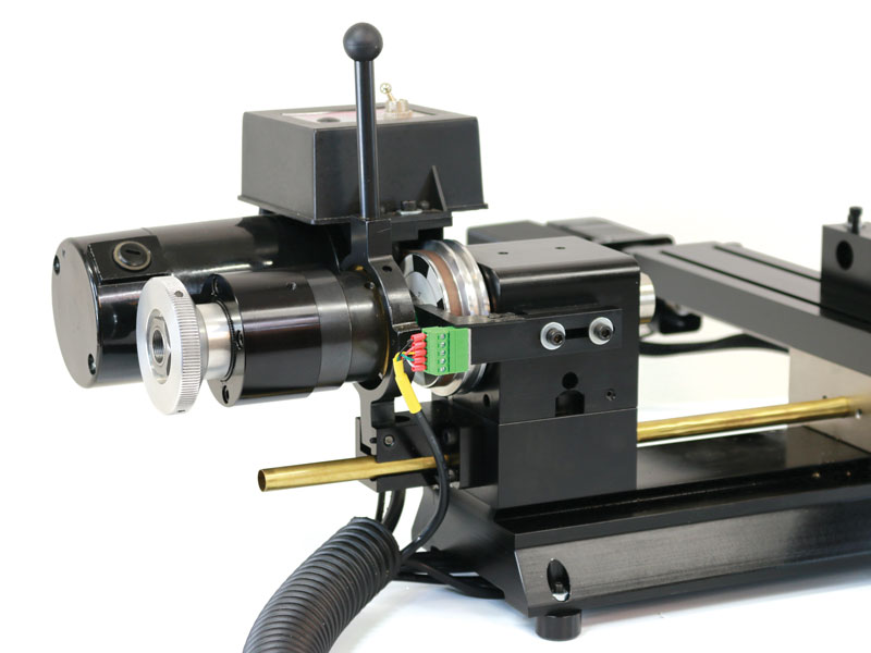

  • Headstock with nickel-plated 3C spindle with precision C5 bearings, and with .001″ or less TIR* (*A TIR of .0005″ or less can be requested for an additional charge.)
  • An Industrial 3C Lever Collet Closer
  • The largest diameter through the collet is ½” (13mm). NOTE: collets are not available through Sherline Products. We recommend buying them from Hardinge.
  • Oil reservoirs on the X/Z saddle to help keep critical parts lubricated

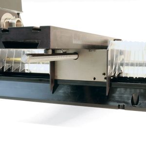

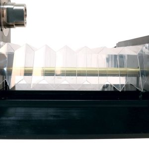

  • Accordion way cover and brass-tube leadscrew cover that keeps chips off of the Z-axis leadscrew

Note: Photos show a chucker lathe with gang-tooling options

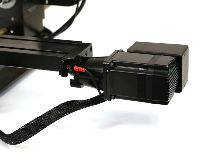

Stepper Motor Specifications
Sherline/MASSO 36V, Closed-Loop Stepper Motor Specifications and Troubleshooting PDF
Frame SizeNEMA #23
Shaft8mm (.315”)
Input Voltage36V DC
Output Current4.5A 20 KHz PWM
Pulses/Revolution800
Maximum Torque2 N.m (Newton meters), 20.39 kg/cm (kilogram centimeter), 283 oz/in (ounce inch), 17.70 in/lb (inch pound)
