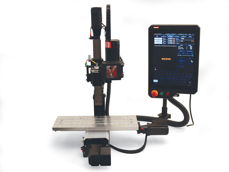

This machine is based on our 18″ NexGen 5800-series benchtop mill. The 18″ mill base with ball screws comes with all-new saddles developed for the ball screws. The X/Y-mill saddle has been beefed up to accommodate the larger ball screws, and it has an electroless nickel/Teflon coating. The nickel coating offers a hard surface that is rustproof, while the Teflon provides a friction coefficient of .1-.2u for smoother movement of the saddle and the table. The Accu-Pro Mill also includes 36V closed-loop stepper motors with #23 NEMA frames, motor mounts with high-torque couplings, and C5 bearings in the headstock for smoother spindle operation.
Ball Leadscrew Specifications
  • 10mm Diameter, 2mm Lead
  • C7 Accuracy*, P1 Preload
The ball screws are only available in metric.

The Axes of Movement of a Sherline 18″ Ball Screw Benchtop Mill.
CNC-ready version shown for reference.
The table left/right movement is referred to as the X-axis. The table in/out movement is the Y-axis. The headstock up/down movement is referred to as the Z-axis. The headstock can also be rotated on its saddle on Sherline mills (#4), the column ram can be moved in and out (#5), and the Z-axis column can be tilted forward and back (#6).

Ball Screw Machine Specifications
Max clearance
(table to spindle)
12.875″ (327 mm)
Throat
(no spacer)
Adjustable
Throat
(w/ headstock spacer)
Adjustable
Travel, X-Axis12.80″ (325.1mm)
Travel, Y-Axis11.00″ (279 mm); 8.9″ (226 mm) with the tooling plate attached
Travel, Z-Axis9.25″ (235 mm)
Spindle nose taper#1 Morse
Width Overall*25.25″ (641.3 mm)
Depth Overall*Base footprint: 26″ (660.4 mm); With fully extended brass leadscrew cover: 33.25″ (844.5 mm)
Height Overall (Max.)*29.375″ (746 mm)
Hold-down provision3 T-Slots (with 7″ x 13″ tooling plate)
Shipping Weight82 lb. (37.19 kg)
Movements in addition
to X-, Y- and Z-axes
Rolled Ball Screw with BSH Nut
C7 Accuracy*, P1 Preload*C7 accuracy has a linear tolerance of 50 micrometers / 300mm or .002″ / 12.0″.
Stepper Motor Specifications
Sherline/MASSO 36V, Closed-Loop Stepper Motor Specifications and Troubleshooting PDF
Frame SizeNEMA #23
Shaft8mm (.315”)
Input Voltage36V DC
Output Current4.5A 20 KHz PWM
Pulses/Revolution800
Maximum Torque2 N.m (Newton meters), 20.39 kg/cm (kilogram centimeter), 283 oz/in (ounce inch), 17.70 in/lb (inch pound)
