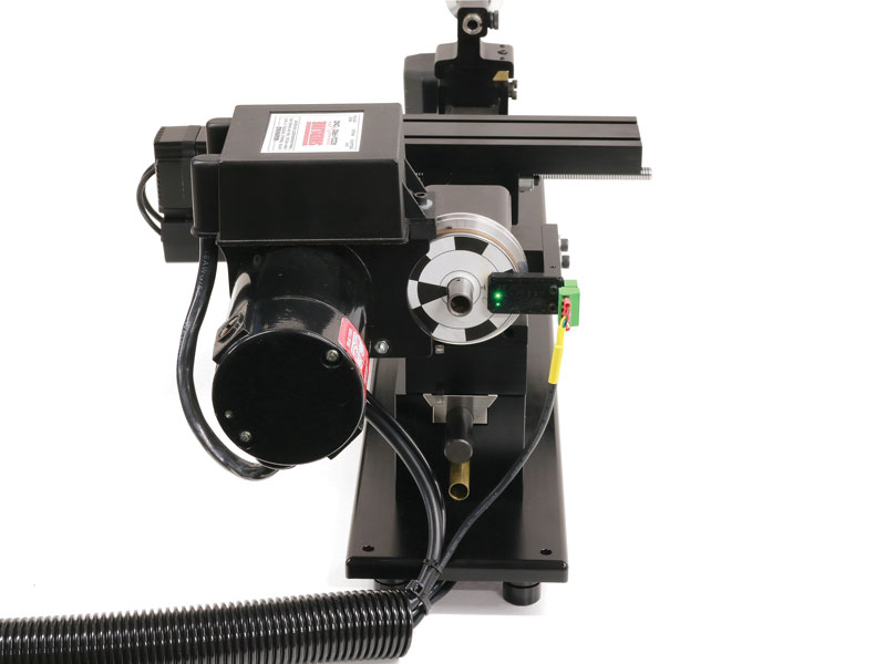

About the Accu-Pro Turn Benchtop Lathe System with Ball Screws

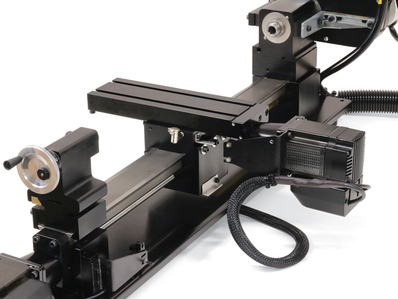

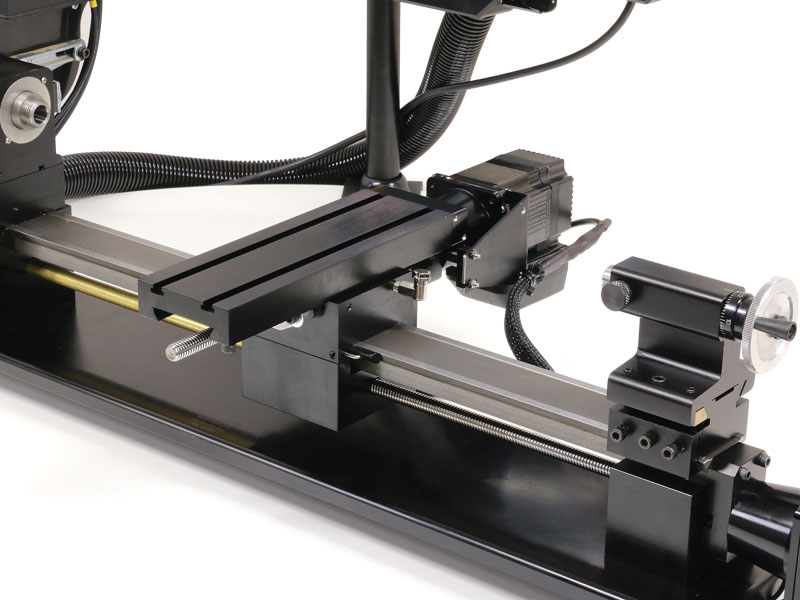

The ball screw lathe design is a reimagined version of our popular 17″ 4400-series benchtop lathe. The lathe has a new solid aluminum base, which creates a very rigid assembly, a beefed-up saddle to accommodate the ball screws, a larger 8″ crosslide, 36V closed-loop stepper motors with #23 NEMA frames, motor mounts with high-torque couplings, and C5 bearings in the headstock for smoother spindle operation.
Ball Leadscrew Specifications
  • 10mm Diameter, 2mm Lead
  • C7 Accuracy*, P1 Preload
The ball screws are only available in metric.

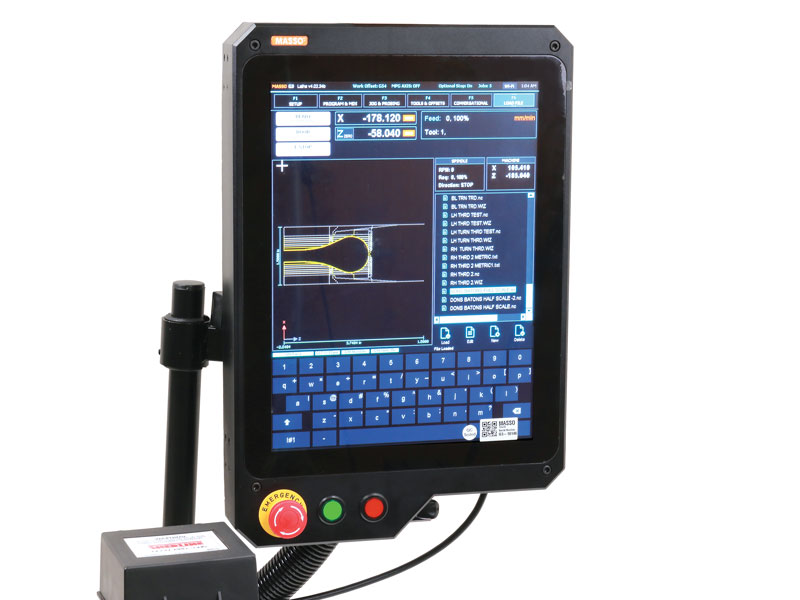

About the Sherline/MASSO CNC G3 Touch Controller
The MASSO Touch Controller with power supply and spindle drive card lets you input data to the controller via a state-of-the-art touch screen. With MASSO, you can write your CNC programs on your computer (Windows, Mac, Linux, etc.) and then transfer your program to the controller via a USB flash drive. You no longer have to use a dedicated operating system like Linux or Mach 4 to control your machine.
The Touch Controller includes:
  • Industrial cable system from the controller to the machine
  • 36-volt power supply
  • Touch-controller stand
Do you want to know more about the Sherline/MASSO G3 CNC controller? Here are some resource links for your reference.

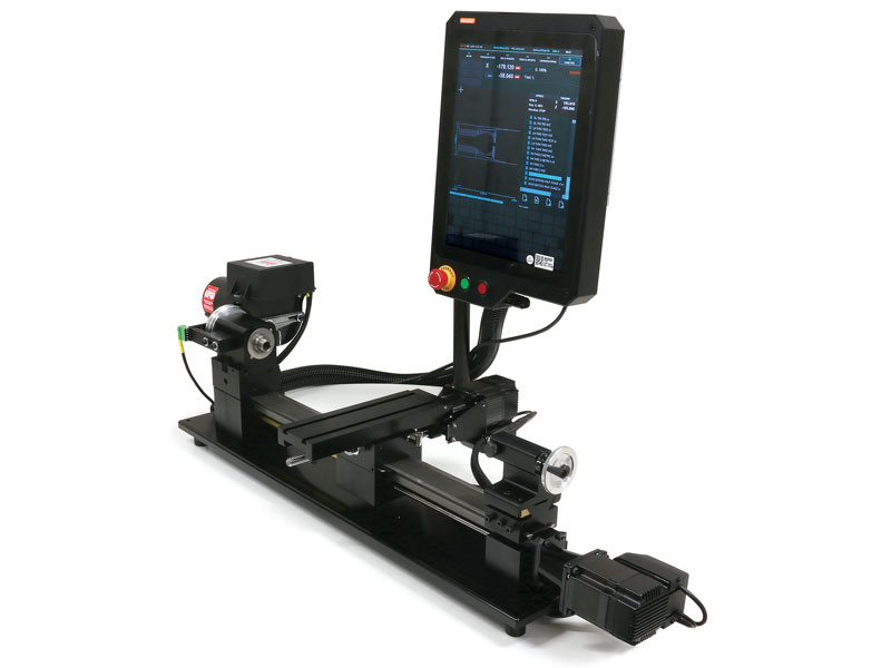

The MASSO Accu-Pro Turn Benchtop Lathe System Package includes the following:
  • 17″ benchtop lathe fitted with ball screws and an all-new saddle developed for the ball screws
  • A Sherline/MASSO G3 Touch Controller
  • G-code Spindle Speed Control with threading capability
  • An optical encoder
  • WiFi is standard with the MASSO G3 Touch Controller

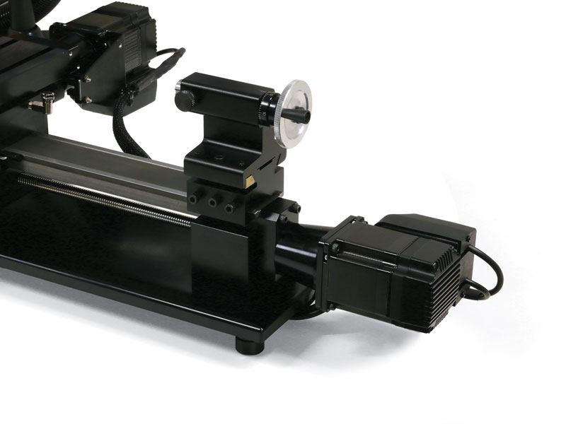

  • Two 36-volt, Closed-Loop, High-Torque Stepper motors with a 70 in/min maximum feed rate
  • Professional cable wraps and covers for the X- and Z-axis
  • MASSO homing sensors on all axes
  • USB 4 GB flash drive (With software, machine settings, sample programs, and PDF instructions included.)
  • 1-year warranty on all machine components for non-production use. 90-day warranty on CNC and electronic controller-related components

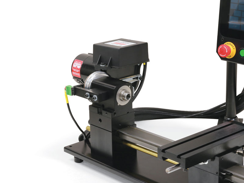

Standard equipment for the Accu-Pro Turn Benchtop Lathe includes the following:
  • A powerful 90V DC motor with an electronic speed controller
  • 8″ crosslide
  • Headstock with #1 Morse taper, 3/4 x 16 spindle thread with precision C5 bearings. You can also order the optional nickel-plated 3C spindle with .001″ or less TIR*. (*A TIR of .0005″ or less can be requested for an additional charge.)
  • 3/8″ Insert holder tool post (P/N 7600)
  • Oil reservoirs on the X/Z saddle to help keep critical parts lubricated
  • Brass leadscrew cover that keeps chips off the front of the Z-axis leadscrew

Ball Screw Machine Specifications
Swing Over Bed3.50″ (90 mm)
Distance Between Centers17.00″ (430 mm)
Spindle Nose Taper#1 Morse
Handwheel Graduations.001″ (.01 mm) (Tailstock only)
Length Overall36.00″ (914 mm)
Width Overall11.25″ (286 mm)
Height Overall8.00″ (203 mm)
Shipping Weight69 lb. (31.4 kg)
Motor90 volt DC with electronic speed control that accepts any incoming current from 100 VAC to 240 VAC, 50 Hz or 60 Hz.
Maximum CNC travel speed, X and Z70 inches/min
Rolled Ball Screw with BSH Nut
C7 Accuracy*, P1 Preload*C7 accuracy has a linear tolerance of 50 micrometers / 300mm or .002″ / 12.0″.
Stepper Motor Specifications
Sherline/MASSO 36V, Closed-Loop Stepper Motor Specifications and Troubleshooting PDF
Frame SizeNEMA #23
Shaft8mm (.315”)
Input Voltage36V DC
Output Current4.5A 20 KHz PWM
Pulses/Revolution800
Maximum Torque2 N.m (Newton meters), 20.39 kg/cm (kilogram centimeter), 283 oz/in (ounce inch), 17.70 in/lb (inch pound)
