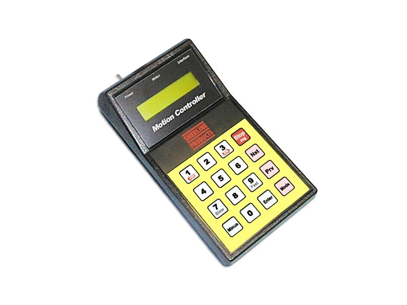

The stand-alone controller is fully programmable via its built-in keypad and manages the operation of the connected stepper motor.
An 8-pin mini-DIN cable allows multiple controllers to be linked in a “daisy-chain” configuration. The controllers can signal each other to operate in sequence, enabling complex, multi-axis movements without the need for a computer or master CNC controller. They can also be used alongside existing CNC systems. Each controller can store two independent programs, with up to 40 steps per program. Each step can define distance, direction, speed, and whether the program pauses or proceeds automatically to the next step.
Sherline’s linear controller can also be daisy-chained with the rotary controller, allowing combined rotary and linear operations in sequence. This setup simplifies advanced tasks—such as gear cutting—without requiring CNC programming knowledge beyond what is entered via the keypad.

This stand-alone controller is fully programmable via its integrated keypad and directly controls the stepper motor to which it is connected. The stepper motor can be applied to any axis of a CNC-Ready Sherline machine.
An 8-pin mini-DIN cable allows multiple controllers to be connected in a “daisy-chain” configuration. Controllers can signal one another to operate in sequence, enabling complex, multi-axis movements without the need for a computer or master CNC controller. The system can also be used alongside existing CNC controllers. Each controller stores two independent programs, with up to 40 operations per program. For each operation, you can define travel distance, direction, feed rate, and whether the sequence pauses or proceeds to the next step.
The linear controller can also be daisy-chained with Sherline’s rotary controller, enabling coordinated rotary and linear motion. This allows users to easily perform advanced operations—such as gear cutting—without requiring CNC programming skills beyond simple keypad inputs.

This stand-alone controller features an integrated keypad for easy programming and controls the operation of the connected stepper motor—no external computer or CNC system is required.
An 8-pin mini-DIN cable allows multiple controllers to be connected in a daisy-chain configuration. Each unit can send and receive signals to operate in sequence, enabling multi-axis motion without a master CNC controller. The controllers can also interface with existing CNC systems for more complex setups.
Each controller supports two independent programs, with up to 40 steps per program. Each step can define travel distance, direction, speed, and whether to pause or automatically continue to the next command.
The linear controller can also be daisy-chained with Sherline’s rotary controller, enabling combined linear and rotary motion. This simplifies more advanced tasks—such as gear cutting—without requiring any G-code knowledge beyond the simple keypad inputs.
